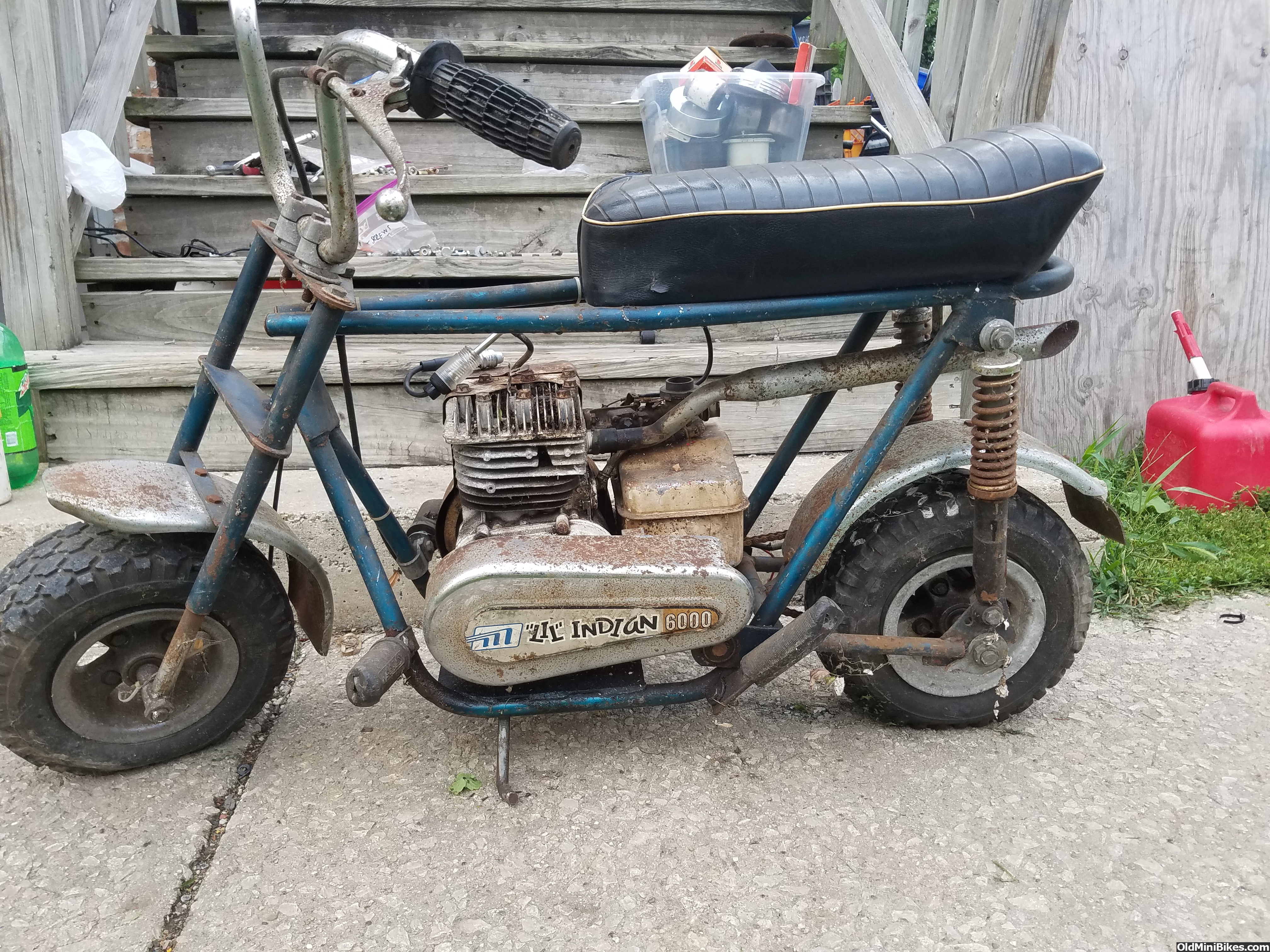

Thanks Joe51. I believe I have a 1968 -69 Grand series 6000. It has the 5hp Briggs, front and rear suspension, Non folding chrome handlebars, solid white painted wheels, Rear disc brake only, full length chrome exhaust pipe, chrome fenders, jackshaft with 2 speed, original color is dark reddish brown. Frame number is 30574. I have seen some info (catalog photo, magazine article) that shows the early Grand series 6000 to be set up like this and that they made updates to the mag wheels, folding handlebars and then Tecumseh engines. I am trying to pin down the date/ year this happened. Thanks in advance to you and any others with pics or info to help figure this out. Jim

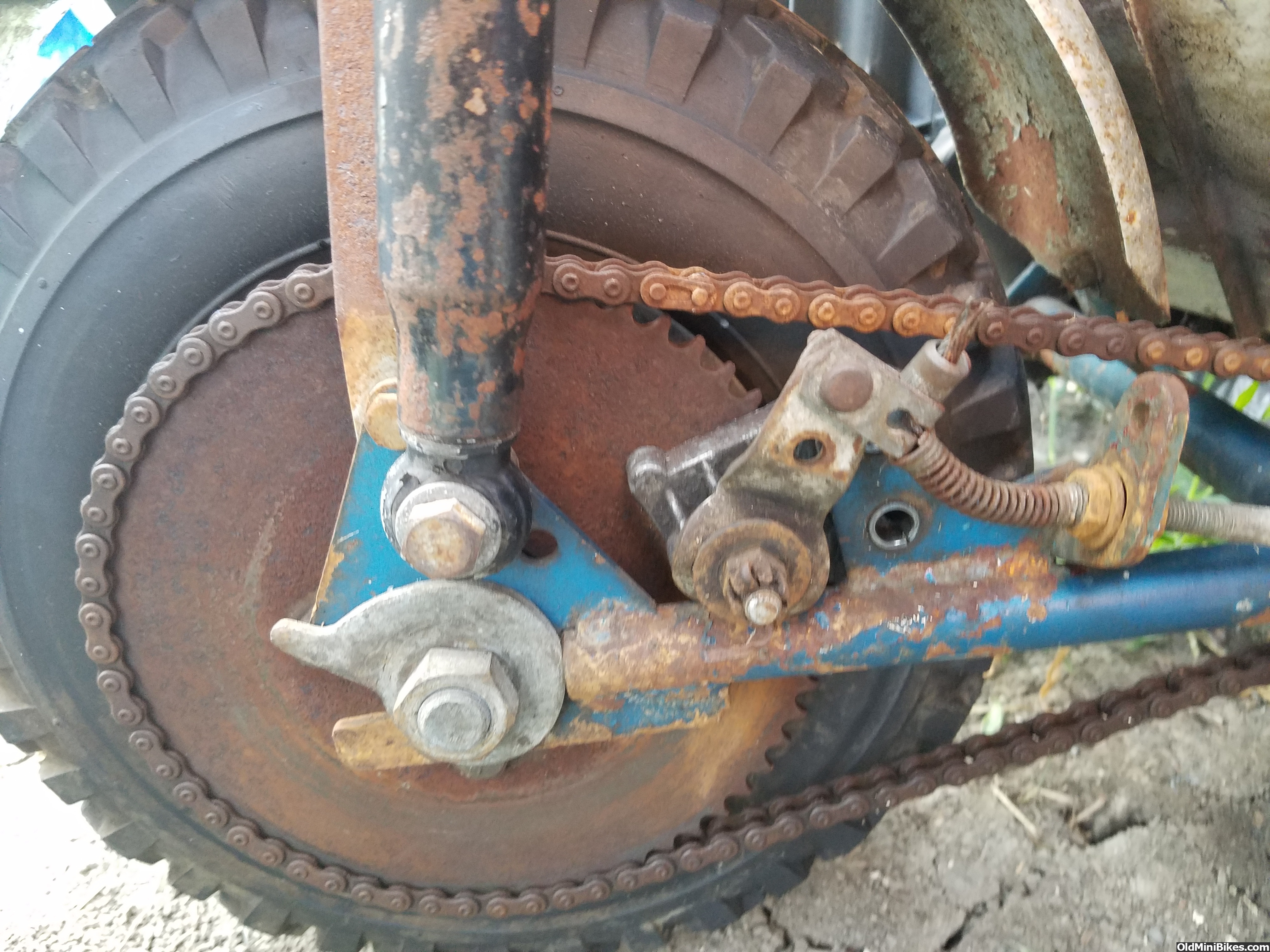

It would be a 1968 6000. The info I'll get to you will have everything for that year bike. I have the same. 1969 was the year swap to mag wheels and fold down handlebars. Early 69 bikes had a plate/fold down set up that was mounted on top of the top triple tree. ( basically two top plates). At some point they made it into one. Hard to pin down when that happened. 68 rear swing arm was different than 69. It should have a flat plate on it with slots for the brake and the adjuster plate. Chain guards for 68 and 69 were the same with the Briggs.

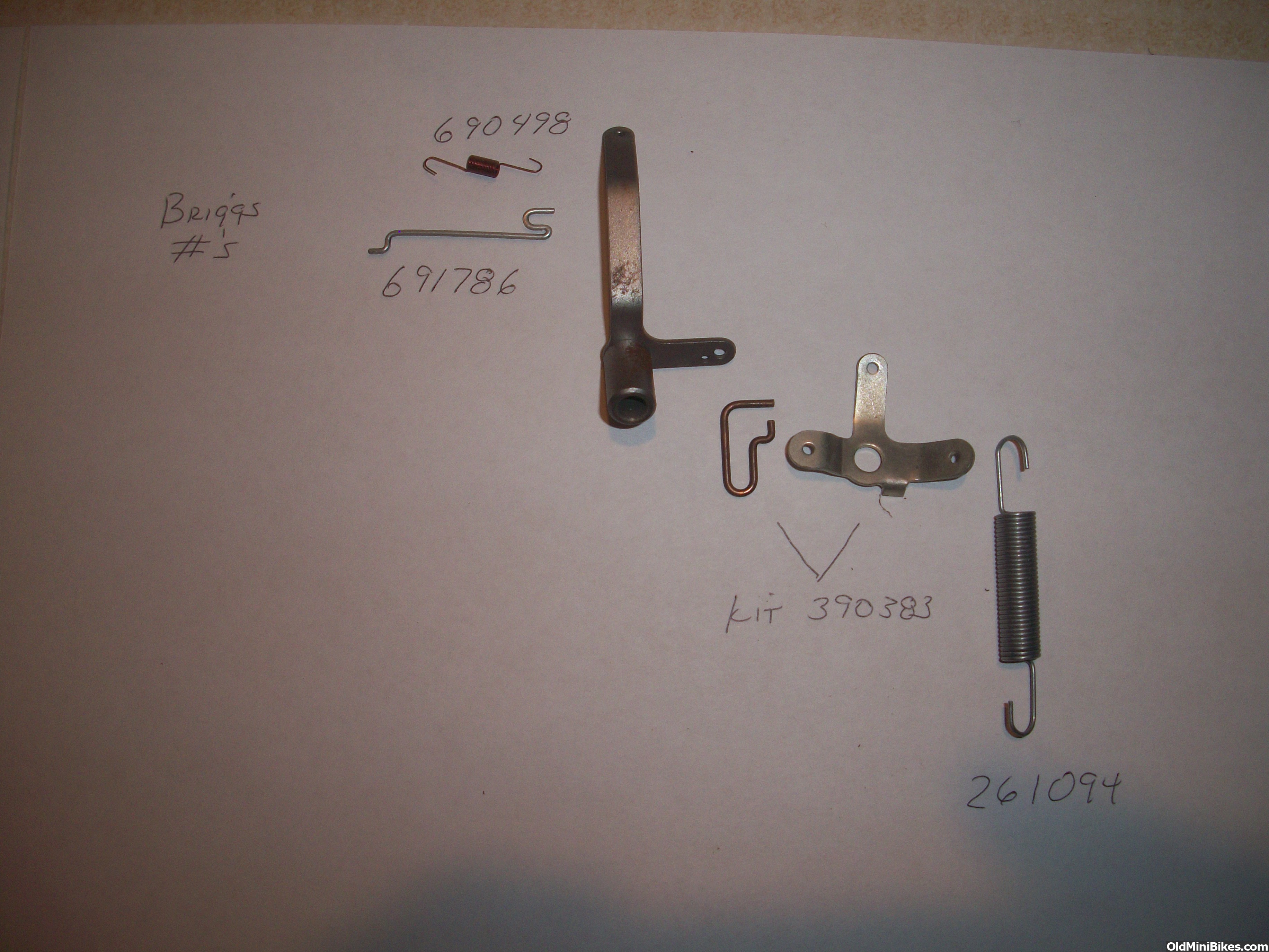

By any chance does your 5 HP have a small L bracket mounted to one of the breather screws? I need to make a repo for mine.

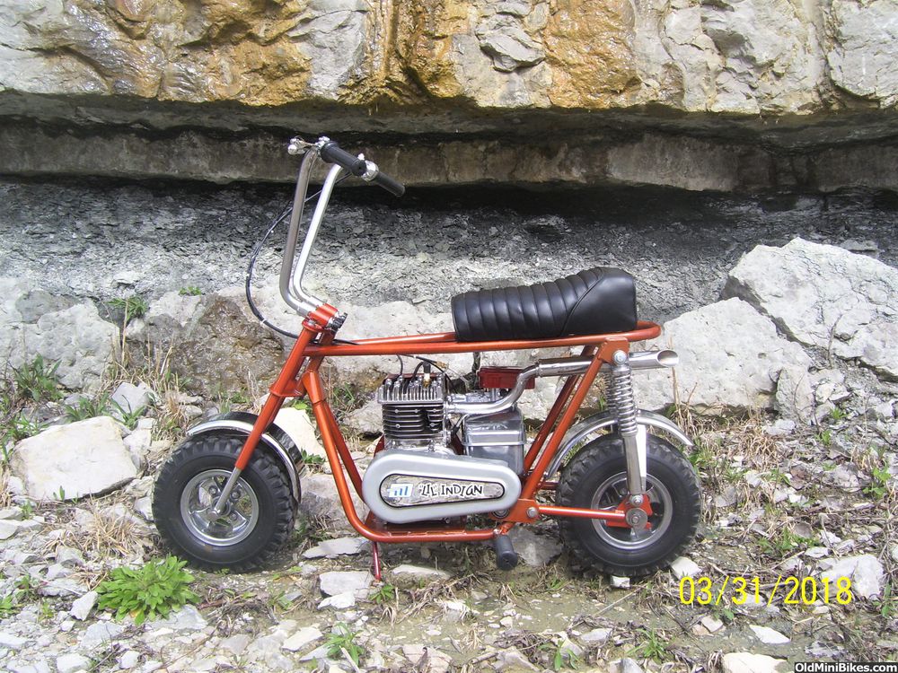

I think Joe51 and Markus have done there home work on these lil Indians , here's a pic of my Briggs only frame possible 68/69 cross over bike with fold down bars, rear foot peg and mag wheels. I think oldcarcbx bike would be a 1968 ….just my opinion.
Best I remember Briggs quit making mini bike engines in 1970/71 and Lil Indian had to change engine mounting plates for Tec engines .

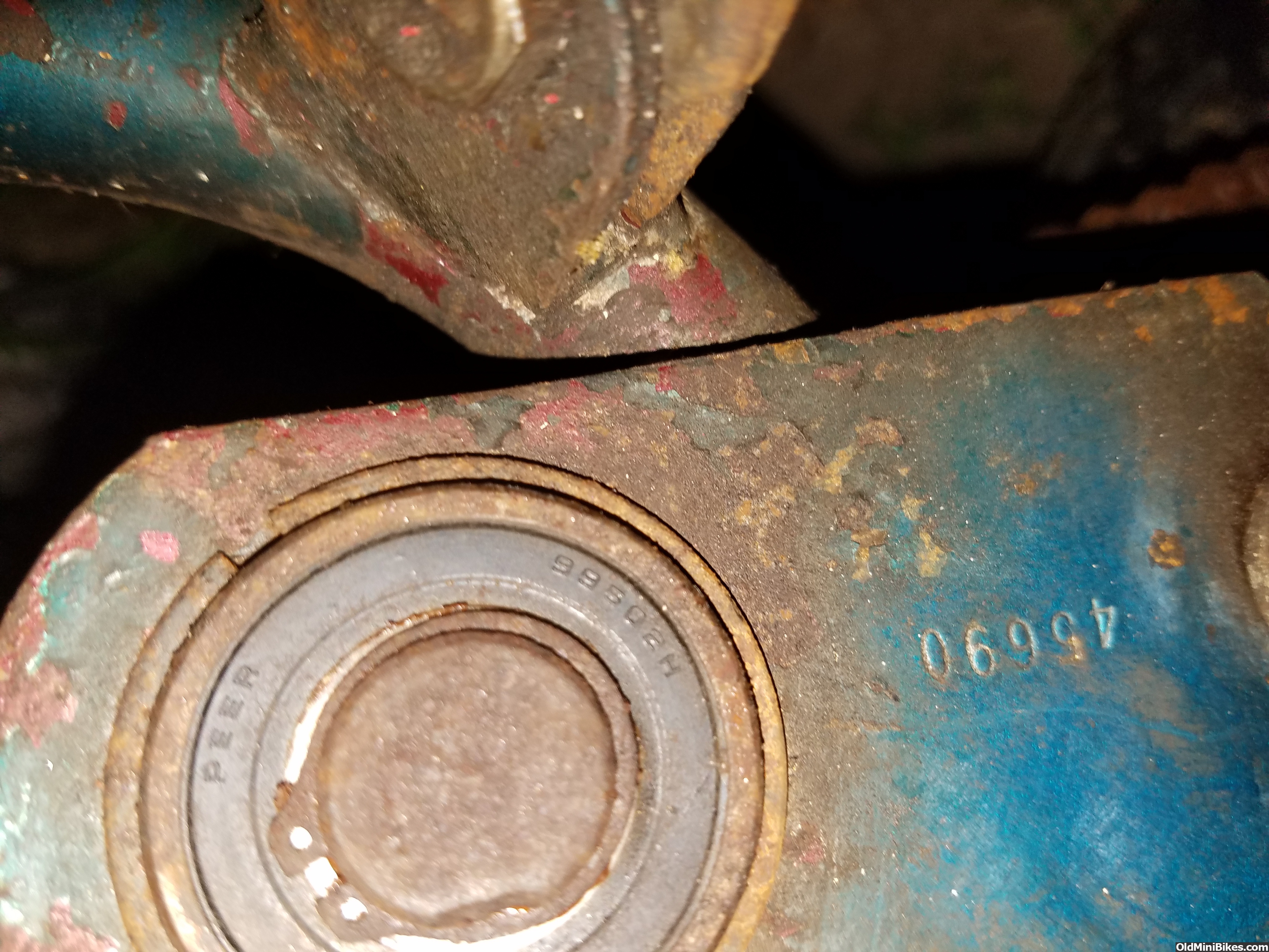

#14
Hi OND,
Could you share your frame number with us, I think it would help track the sequence of the progression of the changes Lil Indian was making on these minibikes. Thanks, Jim
#15
RuppKing,
Thanks for those bracket dimensions. Any chance you can add what thickness the material is? And yes, it is a throttle return spring bracket.
I'll post up the other parts that go with it for a correct 5HP application.

#20
Joe51, That spring bracket is .060" thick.
RuppKing,
