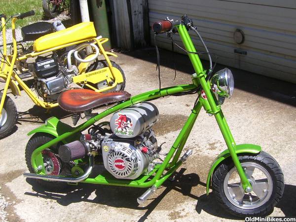

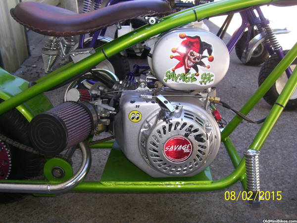

Hey Gene, I bought a bobber/chopper seat off ebay for my Savage, and I like it I think it fits good. Got any pics of your seat on the bike ?
