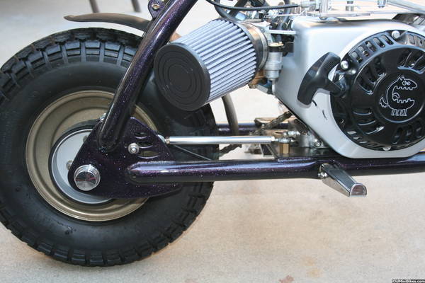

I have the stock drum brake on my Murray...I have a predator with a cam and pipe...I am 270+ lbs, and I can lock the back wheel up! I made a strut to go from the motor plate to the pivot point for the cable. Gets rid of any play and lets you get some real brakes! I did use new parts ...forgot where I got them, but they are from a Carters Bros go kart

Not to hijack, but where can I get bolt caps like you have on the rear axle??

It is a bunch of fine tune adjustments to make it work...too tight it drags, too loose, no grip. I also have an aftermarket pit bike lever that does not flex much. Really think about adding a strut...that was a huge improvement for me!
When I adjust it, I make it so the hand lever is tight on the drum about halfway in its travel...that way if I need to stop I can really "jump" on it.
The purple bike here also has a Benelli front wheel with a drum brake I added that because my first Murray was such a poor braker...but that was before I added the strut. Are both parts of your brake in good condition? If the pad is glazed, you can try sanding it. If it has oil on it, you can try to replace it!
