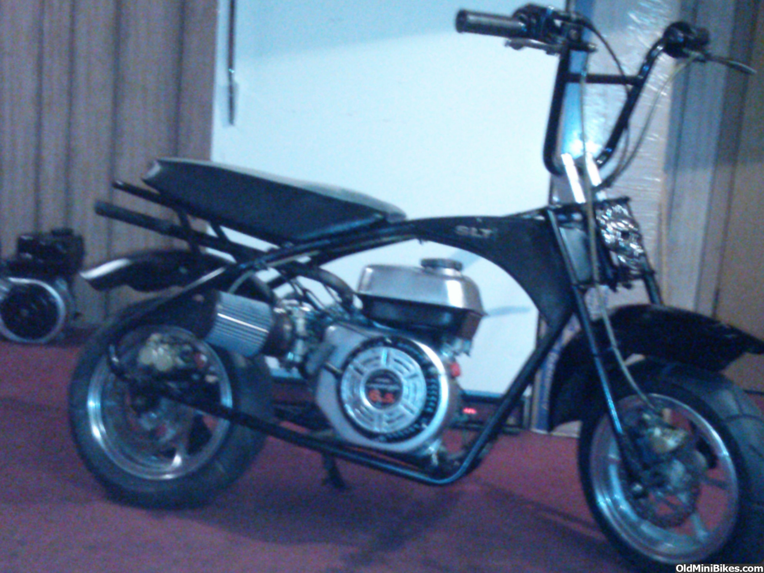

i gave up building bikes for a while, but with all the snow I decided a on a new project. I wanted a murray track 2 since I rebuilt one for this guy son, it had a 5.5hp honda and pulled wheelies all day.I could not find a cheap tracks so I put my money in a jangdong blue clone, it has arc rod .020 over ,flat top piston ,gx160 head, 18lbs springs, black mamba jr cam , &rvl flywheel. this was only my second zengine build & my motor screams.
a buddy of mine had a mbx10 he was tired of so we made a trade then he lost interests so I got free mbx10. I like the ride of mbx10 with the clone he had on it but I knew it needed better wheels like on the track2. I looked around & came up with x18 pocketbike wheels & brakes which will be need with my clone. the mbx20 motovox is suppose to come out with is made for off rode. my version is made for street, so I call it SLT street light track edition. i love the way the bike looks & can't wait to test &tune it.
