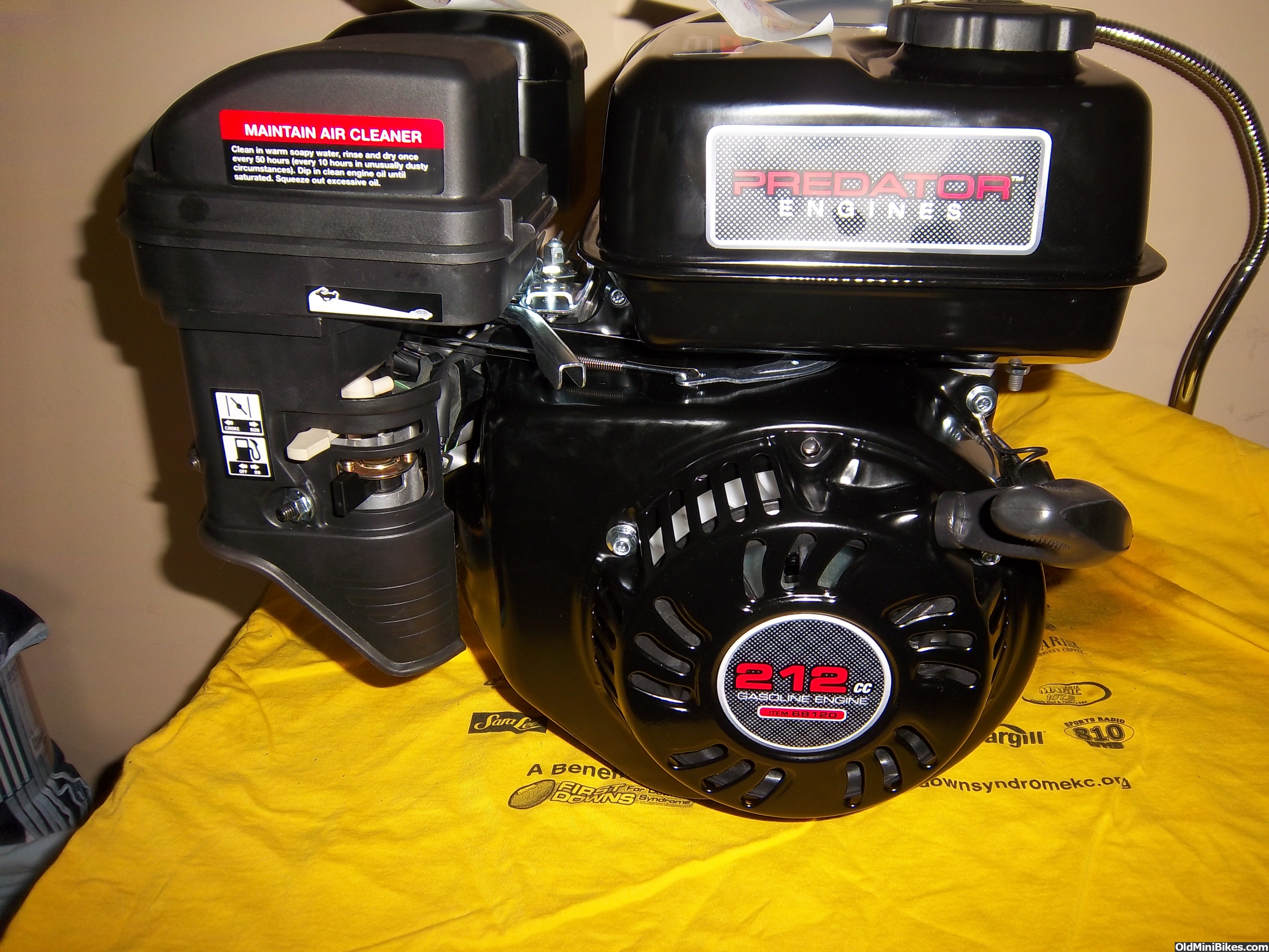

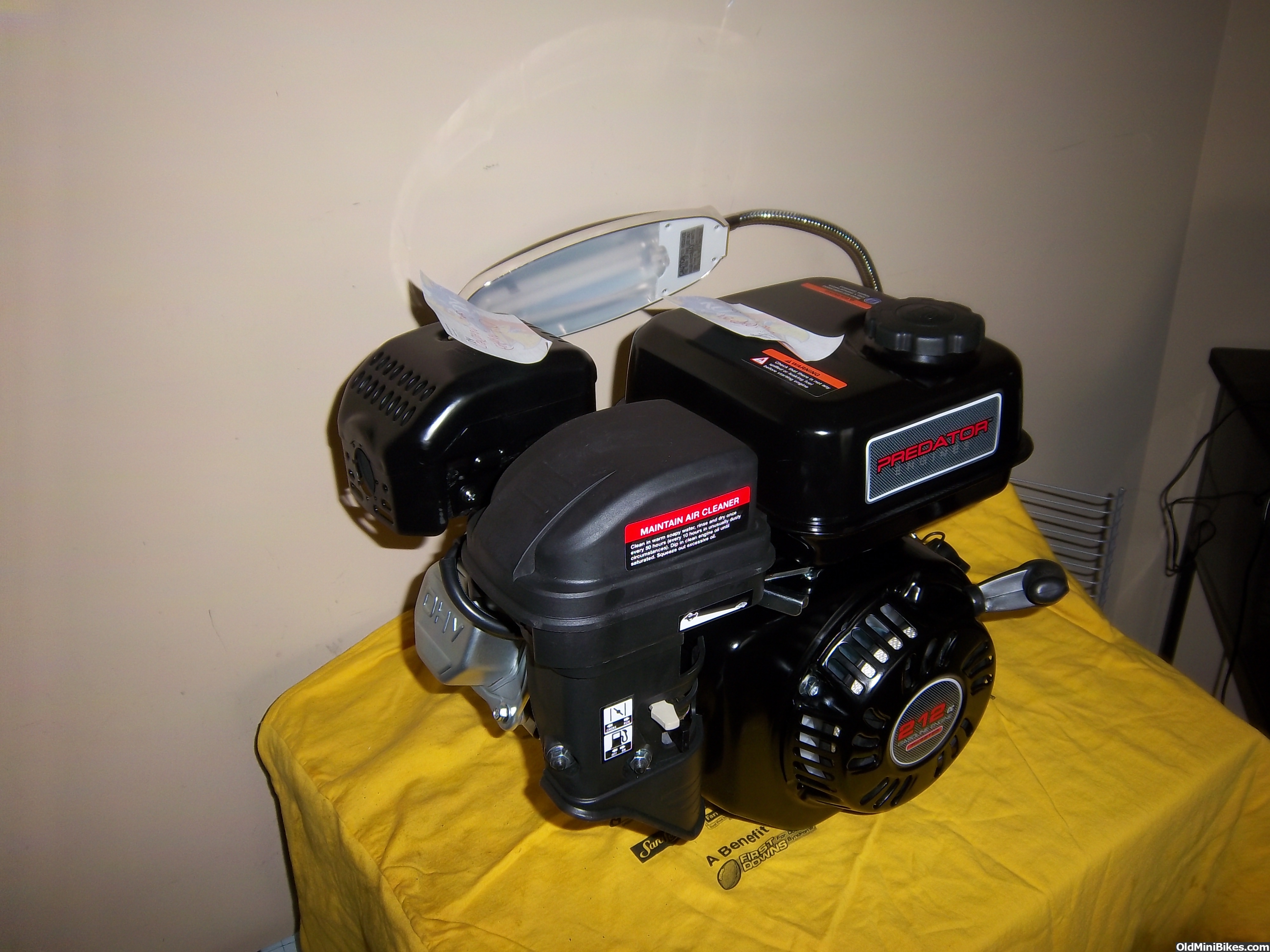

Hello! I am new here but I have been browsing the forum for about a week.
I am working on a mini-chopper build, which I understand is not quite on board with this forum, but this is the only forum I can find that really knows what they are doing, especially when it comes to honda clone engines. The reason I didn't start a new thread is that I am here to talk about the predator engines. I recently bought the 212cc model this weekend and I have pictures in exchange for some answers.
First question: Can anyone if these are real clones or too far from the honda to use the aftermarket parts? Specifically, the billet rod, as I have jumped the gun a little and already torn out the inside governor.
I can take more pictures but here is what I have now.
I take requests.
(Actually I can't get this picture uploader to work right so you will get them when I can put more up...)

Stock HF rod is 3.303"
Predator -
Crank Journal: 1.182
Cam Journal: .555 (Cam has plastic gear)
Bore: 70mm (2.756)
Stroke: 55mm
Wrist Pin: .702
Rod length: 3.297
