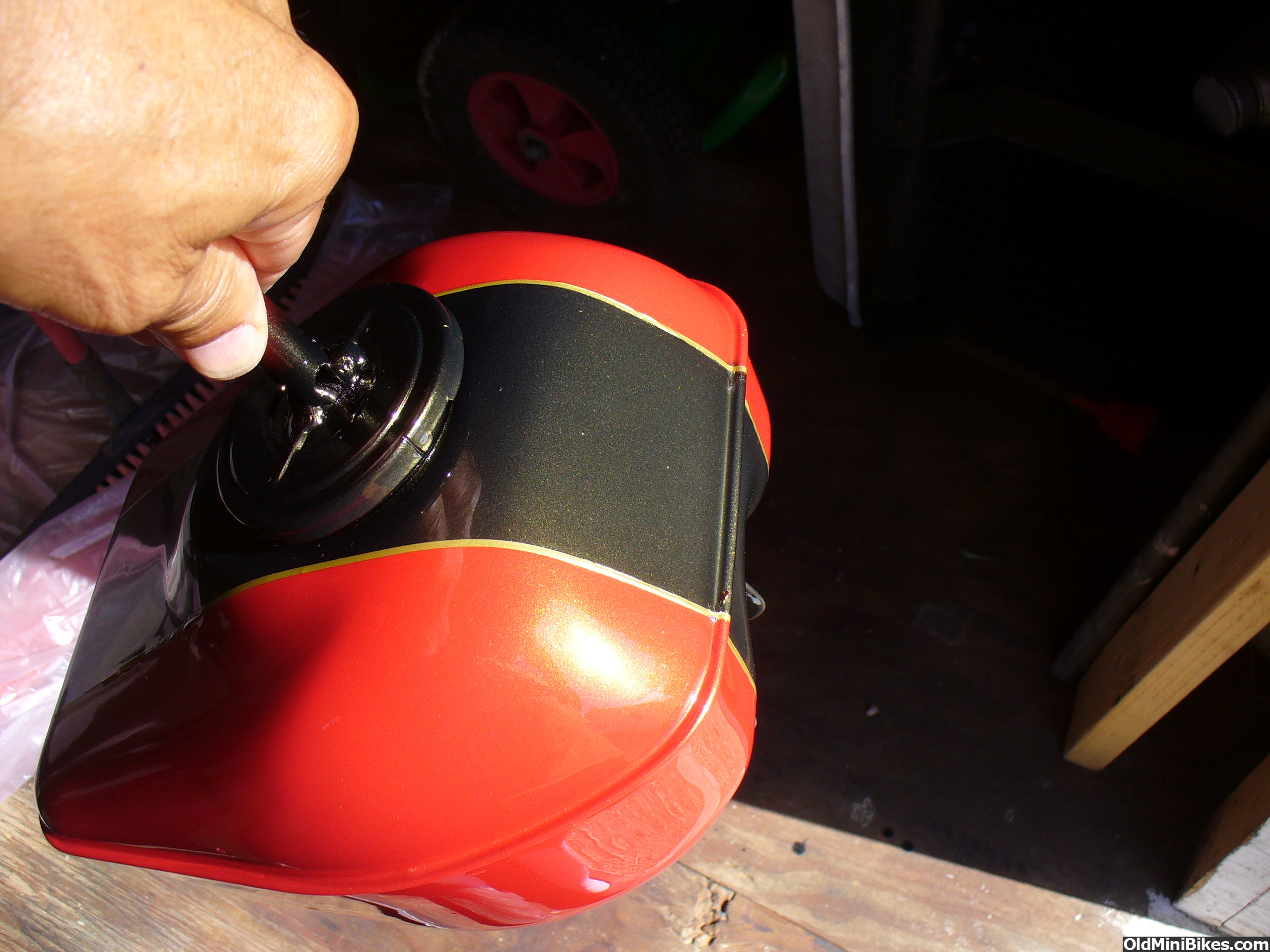

Just got back into painting things. Most recently, I just did a motorized bicycle (China girl) tank. Wire-wheeled all of the nasty black oil paint which was bubbling & flaking) off, soldered the joint between the mounting bolts & the welded lock-nuts inside of the tank, muriatic acid dip (to get rid of all of the crap, and remove surface oxidization), a plunk in a basic solution of baking soda & water to neutralize the acid, and then rinsed in water. Later, it was cleaned with acetone, dried, two coats of primer, light sanding, and is now on it's second coat of Ford Blue enamel. Soon to be wet sanded and another coat applied.
Thinking about taping off a stripe down the middle (lengthwise), and hitting the rest with another coat of primer & arctic white for that 1965 Shelby GT350 feel. :wink:
Surface prep surface prep surface prep :grind:
Anyone else here have paint tips & tricks? Photos? :laugh:
I know some of you guys do an absolutely stellar job with paint & I LOVE seeing the work.
