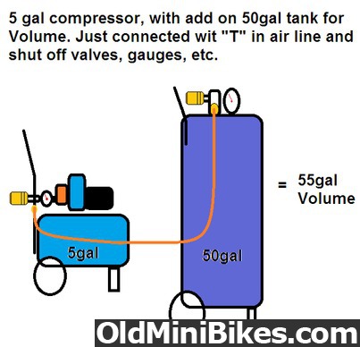

So I should get a regulator and not use the one on the compressor.
Yes, I have regulator & gauge at the gun. Volume of air should not be an issue but, if it is.
This is how I solved volume of air issue. Without buying a bigger compressor.
Most times you can find a tank like this for FREE as someone blew up the compressor part.
