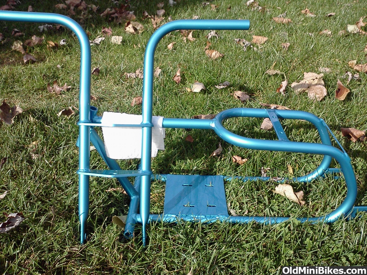

Did a spray paint job on new mini bike kit. This was a new kit - no rust or anything. First sanded then cleaned with mild soap and let it dry. Then three or four cans of self-etching primer (Dupli-color brand). A few minutes between each coat as the can stated. Then 5 or 6 coats of Dupli-color enamel with 10 minutes between coats as can stated. Then 3 coats of clear, again with the stated 10 minutes between coats.
Let it dry for 8 days. First 2 days were at 60 degrees or so. A couple after got in the 40s and then 50s or so the rest of the time.
Took it down today to put the thing together. The paint is coming off when barely nicked. I'm just sick about it. What did I do wrong? I read threads for several hours and thought I knew what I was doing, but apparently did not.
