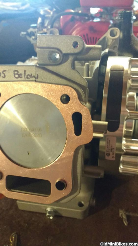

Sad to report that I blew my head gasket racing a friend

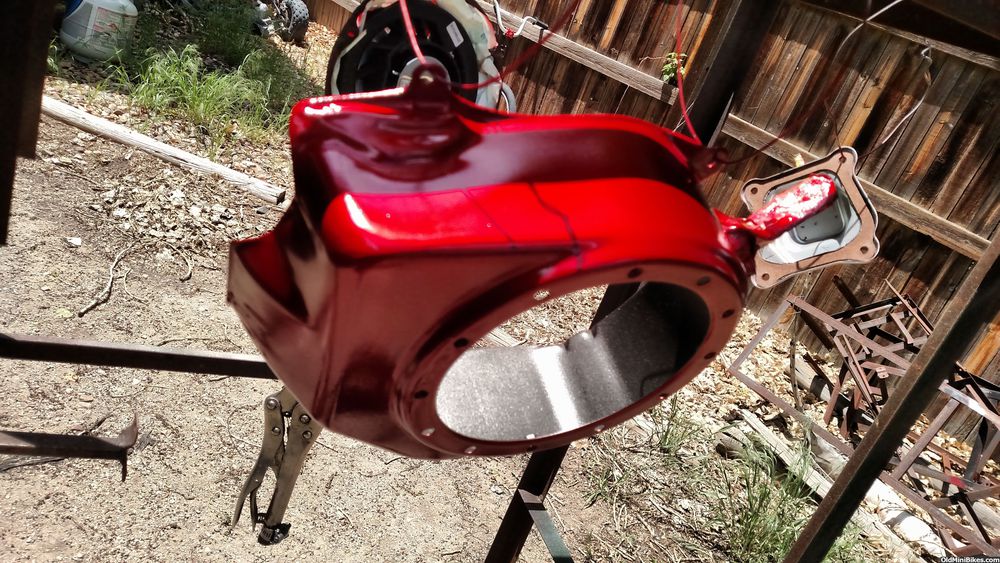

She started sputtering and eventually stalled out and wouldn't restart. Found the leak by spraying cold soapy water on the cold engine and then starting it
This mark was my clue as to what to look for. Have a thicker copper head gasket (.016) on the way from NR Racing.
