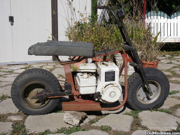

Hello. I am trying to determine what color my Powell Challenger was originally. I am not sure if it's a challenger model or not. The paint looks orange, but there's a color underneath which looks red, or is it primer. The rear pulley looks red, engine stick shift looks red, brake is black over orange or red? Check out my posted pictures.

Red. looks like a 67 or there about wrong engine the engine is a later model

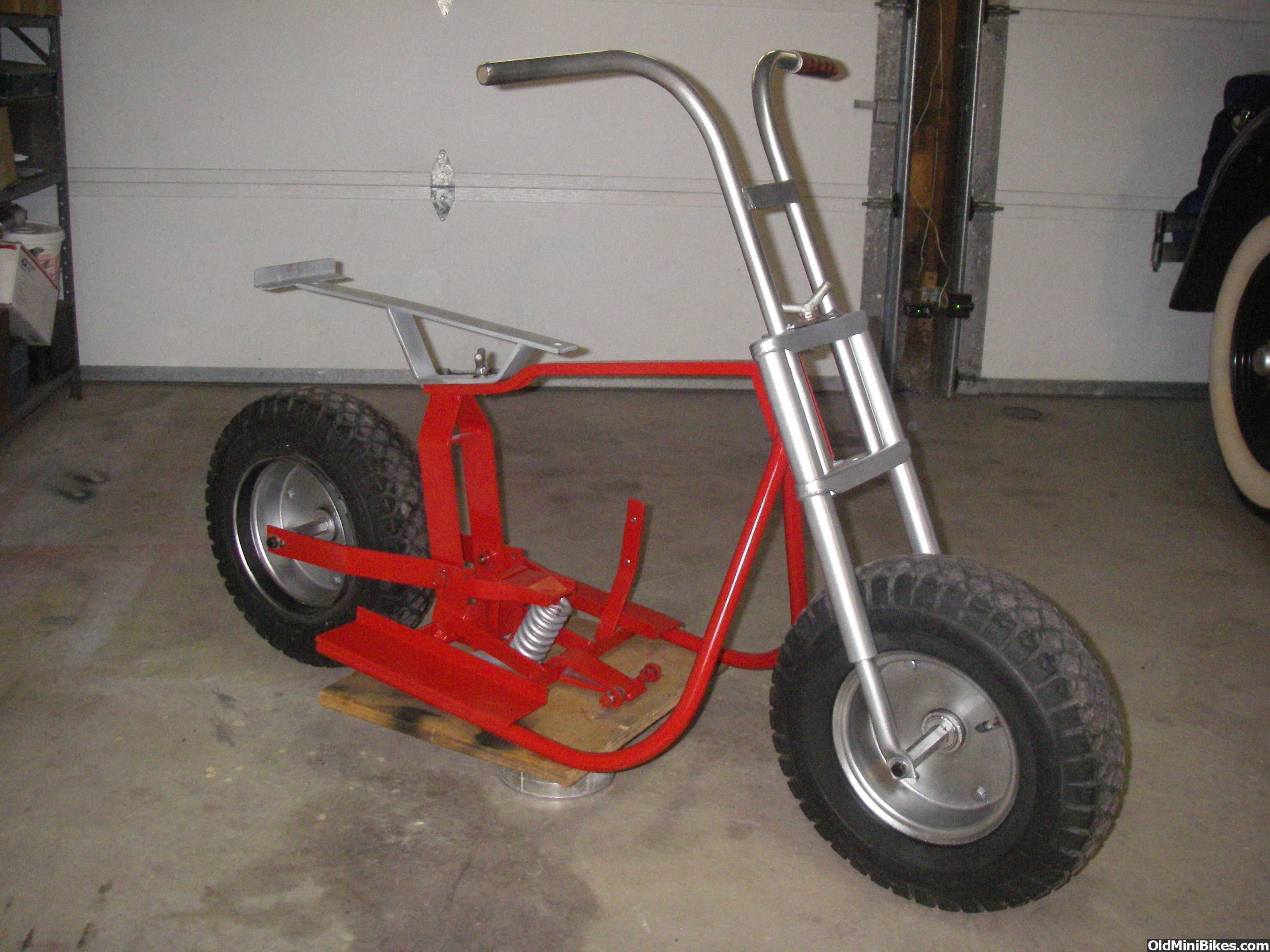

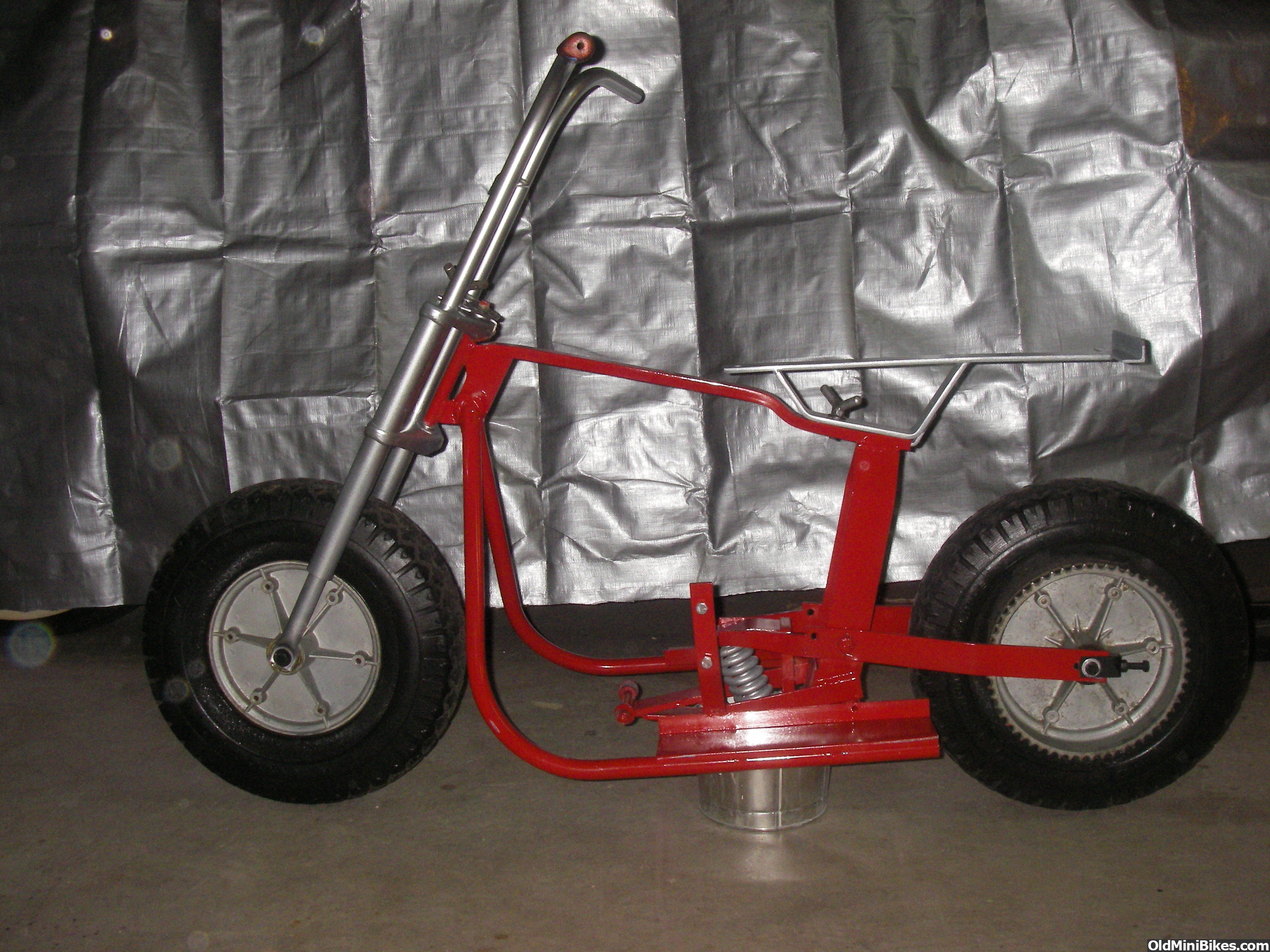

Hello. Yep this is your old bike. I just finished reworking the frame. Replaced the front cross member due to two cracks on either site of motor tongue, and replaced the bent frame tubes. Next I will tackle the engine and clutch work, but not sure exactly what to do there yet. The short engine output shaft is the challenge, but jack shaft and bolt idea you gave me could work.

Killer job you did I breathing new life back into your Challenger..

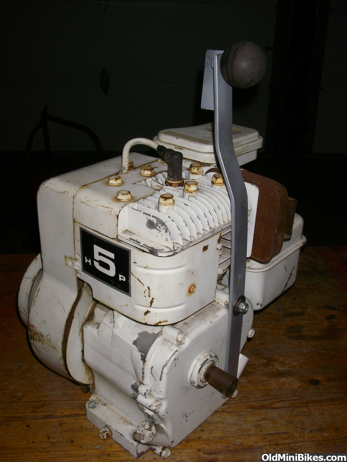

The way you have your shifter mounted to the engine is incorrect..
I'll dig up some pictures of the correct mounting and post them in this tread..

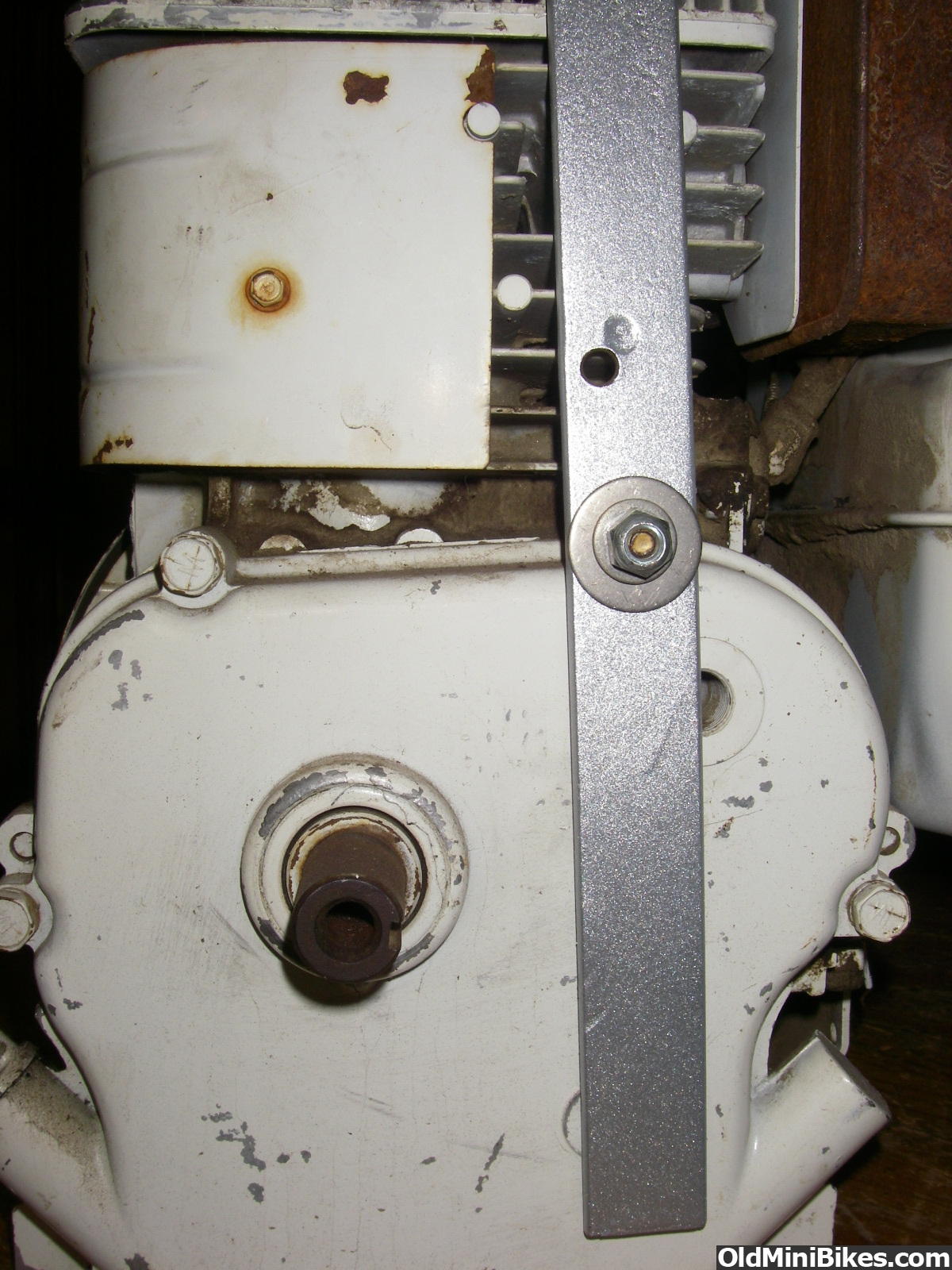

I am not sure if I should try to use this engine with 3/4 dia output shaft, aprox 1.25 inchs long, not any room to put a clutch pully? or use a piece of jack shaft that is bored out so it could be bolted to the existing shaft.
Your shifter arm bolts to that large hole in the engine cover plate. Then the bottom has a circle that is welded to the arm that goes over the small case bolt on the bottom.

Hello. Thanks again for the pictures of the placement of the shifter.
The pic of the output shaft extension is what was described to me by the fellow I bought the Powell from. I will need to purchase one of them. The Briggs in the pic didn't have spark, so installed a new condenser today, added some gas and oil, pulled the recoil and it popped and kicked back and sheered off the flywheel key. Not sure if it was something I did or is just kicked back because it hadn't been started in 30 years.?
