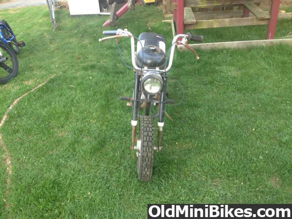

Hi guys Does anyone know by these pictures if this is an Arctic cat Prowler?
The guy said it is an Arctic cat (I know that but I cant see much else.)
It has the wire spoked wheels,saxonette (missing the recoil) and the tank looks different than the SSScat. It's not running, It's listed as make offer.
What would be reasonable.?

Yes. 1972 Arctic Cat Prowler. 1972 Prowler's and Ramrods had 10" spoked wheels and a heavier rear swingarm. They also usually had a throttle with integrated kill switch (red button on the housing). Front forks used internal springs. Everything else was exactly he same as all other 1971 Arctics with 6" wheels. The SSSCat's used the same frames but had a different tank. Everything after them had a teardrop tank. This guy needs to provide more pictures to determine true condition and value.

When I got there I asked him if it would run or could run when he got it and he said it was just the way You see it now. Now I know why he's selling it. Lets start from the front and work our way back. Front tire dry rotted and split needs replaced. chromed rim totally rusted, no holes but pitted. front breaks -froze, front break lever-froze. Front fender missing. Gas tank rusty on the outside plastic dome on the gauge cap missing, couldn't get cap off. Seat cover was OK but the base was rotted. Recoil missing, aluminum gear housing missing, flywheel wouldn't turn (assuming it was seized? or rusted to magneto ) Air box on the carb missing, carb was split all around the primer button (like it had been frozen). Chain rusted stiff, back tire and wheel same as front ,needed replaced and chromed. Rear brakes froze, rear brake lever froze. I couldn't get the bike to roll forward or backwards. Rear fender was there but rusted and pitted.
Oh.. forks were straight, handle bars were good and frame wasn't cracked anywhere. Light was there but no one knows if it works (there were wires detached coming out of the motor).
He wouldn't give me a price so I offered him $35 he said Oh we can get more than that out of it. I told him that it would have to be a total tear down and rebuild just to ride it. and I couldn't even tell if the motor was free. Plus anything usable for parts would have to be fixed first. (it's not even compatible to my SSSCAT I) Unless some one already has the parts to fix it they would be screwed. I cant afford to rebuild it just for a rider.
