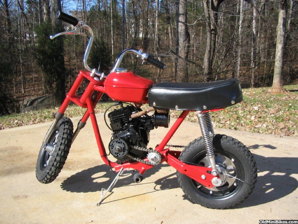

is this what you wanna do?

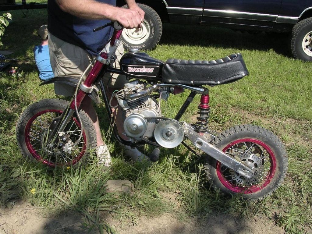

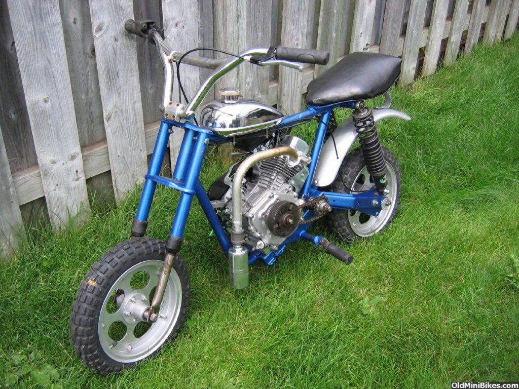

obviously it can be done. heres another one

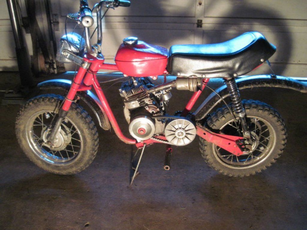

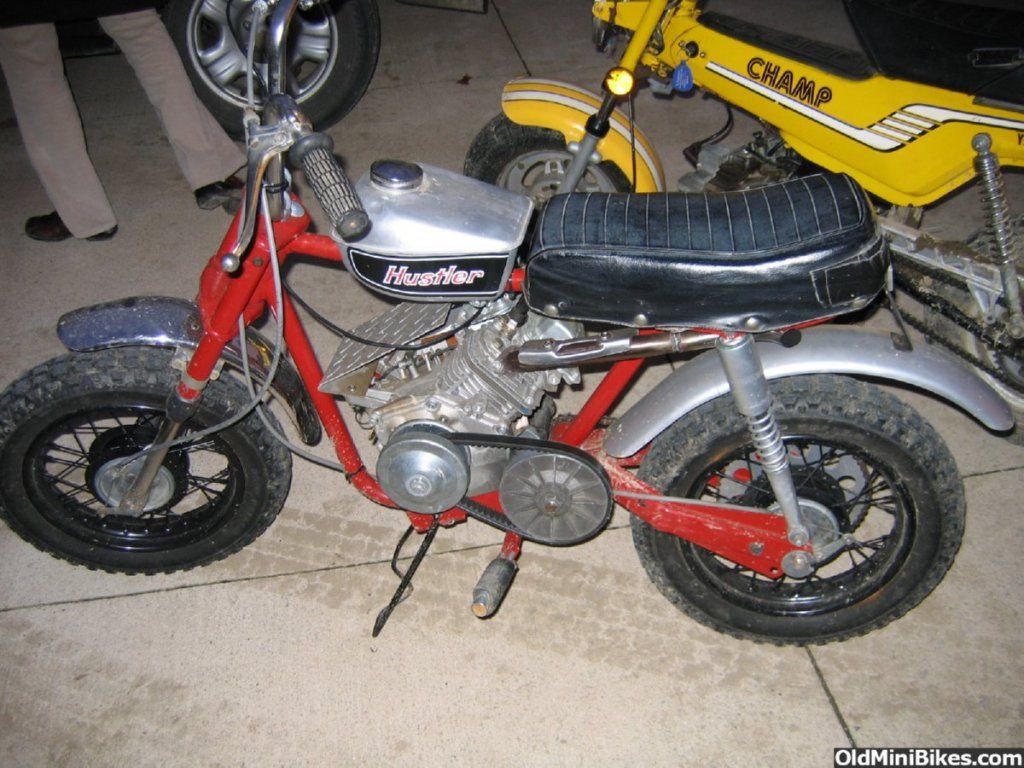

heres one with the different driven also. maybe a comet?

Yes. I was thinking of doing the bottom one, since I need both clutches. I could be happy with the top one also.
well for the top one you need the Rupp driven. if you dont have it, and have to buy both comet parts, they're not cheap and could run you up to around $200.00. what type of shape is the clutch in? If it's in reasonably good shape, you could just as easy get a sprocket and run the jackshaft as it is, just with chains instead of a belt. it's been done before by a few guys!!!
is it gonna be ready for the show room with a clutch set up, no. will you be able to ride the hell out of the thing..... yes!

JRZMAC- I know its a old thread.
How would I go about setting up jackshaft like the orange bike in the 4th picture. Would I need the Rupp jackshaft bearings? Then a 5/8" threaded jackshaft. I kind of assuming like a custom length. Don't know if it need to be have a keyway. Not sure if there's set collars on there too. Then sprockets on both sides.
Any Help would be great.
