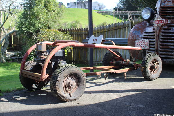

Who doesn't want a 32 Ford Roadster?? I sure want one, so I bought one. Yes yes, I know its not the real thing, but i'd say its close enough.....:laugh:

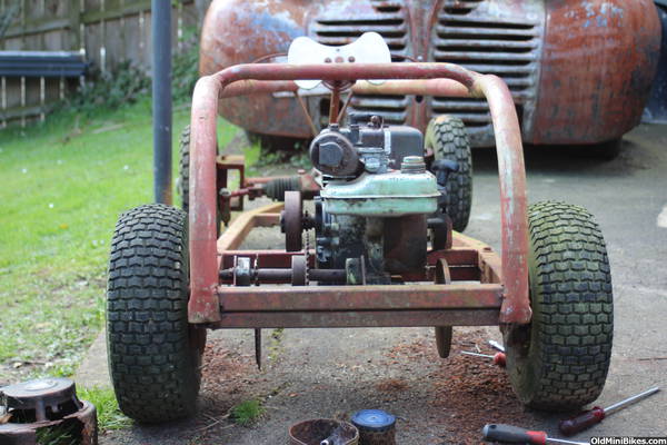

This is what looks to be an abandoned kart project from the 1980s. It also looks to have been sitting under some trees since then, too. The bottom of the frame is practically non existent, what was 30x30 box section steel now lays on my driveway as brown dust. I suppose I didn't help the frame structure when I attempted to sit in it!
However, all of that is reconstructable, and will be reconstructed. What I was more interested in, was the beefy axle setup, and steering box/setup. This kart has a neat little steering box, rack and pinion type. I have stripped, cleaned and painted this already.
The engine that came on it was a mid 80s (1985) Briggs and Stratton 3HP. The Shroud was so rusty that there was no bottom left in it! The gas cap had rusted onto the threads, and there were rocks in the fuel bowl :confused: and holes in the tank. However, being the Briggs whisperer that I am, I had the tank and shroud swapped out in no time at all and had it purring again. I was surprised at the lack of smoke, and how well it ran, and upon pulling the head I revealed a like new motor with very clean cross hatching in the bore :thumbsup:
Unfortunately the Comet clutch did not withstand the test of time and had rusted solid. I did get this un-seized, but it makes a scuffing noise every few seconds. I suspect this to be a bent drum, but I wouldn't be sure.

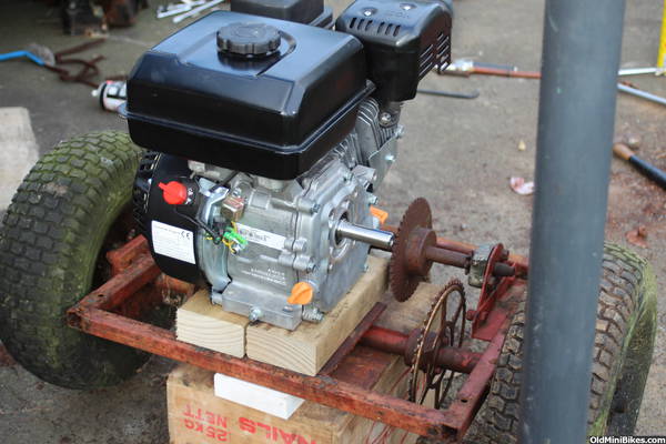

The motor I will be using is a............7HP, OHV engine. I decided to go against my tradition of using flat-heads for everything :scared: But i'm all for the better economy, larger fuel tank, more power, and first pull starting. The engine, a 212cc made in the same factory as a predator, should hopefully interchange parts with a predator if I needed anything more from it. Plus, I probably won't be able to see it anyway.

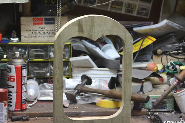

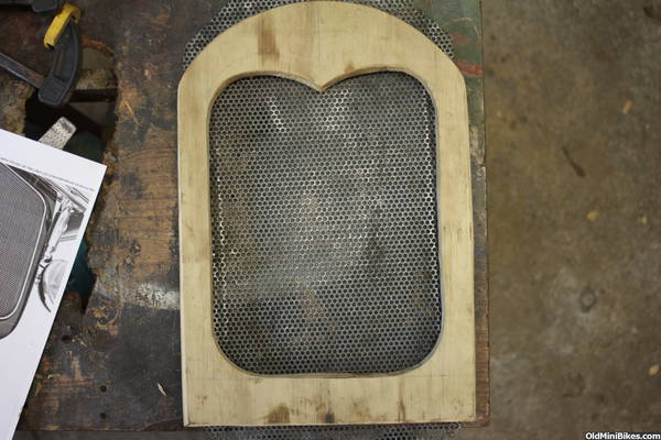

Today I decided to begin with doing the grill as it is too wet to do anything outside right now. At the moment it is just a wooden template that we cut up and formed. I found some mesh with many holes in it (possibly from a speaker?) that I though would be neat to throw behind the grille. Based off the Model A grille (28-29).
Also, I was wondering about what sprockets and gear ratio to go with. Would a TAV make a significant improvement? The kart + person would be pretty heavy! I imagine the current sprocket setup would have been torquey but slow. I think i'd like a balance between torque and speed, not too fast but not walking speed.
#14
I would go with a TAV for sure Jackeo!! Like you said its going to be heavy and I think you will be much happier with performance!!

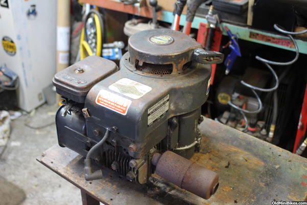

Finally got the new beast today. Shes a model 130902 (9 indicating the vert. shaft). These are the more uncommon Briggs, and im sure that they are certainly a rarity these days. For memory most of these served on large walk behind mowers and vintage ride on mowers (the super early type) in the 1960s and 70s. I'm sure this one came off a large walk behind mower, produced by the Masport brand here in New Zealand/Aus.
It is in great condition, considering it's been around since 1976. Going by the paint condition i'll go ahead and say that its a low hours engine. Awesome!!! :thumbsup:
It goes well, but is a little slow to respond. The spark isn't the brighter blue color that i'm looking for, it's more of a dull orange, so i'll either clean the points or go ahead and replace them with one of my new sets. Ill need a new spark plug too!
I'd like to keep the engine looking the way it does, as the paint is just too nice to strip off and start over. I feel that I will base the rest of the paint scheme off the engine, clean, but slightly worn with obvious signs of use.
