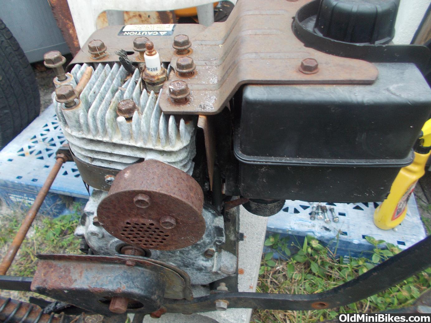

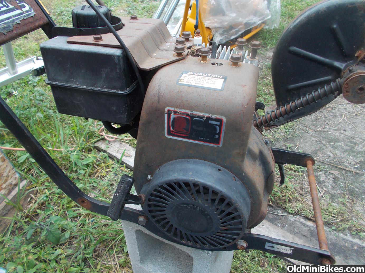

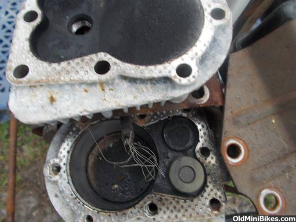

Got a seized side pooper I was gonna toss out, but here is the Grumpy Jenkins trick
to bring back any of our cherished lil engines.
Take the head off, and soak the cylinder with PB Blaster. Let it sit for a day or
two and then take a softie and knock it once. if it moves try it again 2morrow.
The key is just to take your time, and you will find the cyclinder walls will love you!
Here is my first day. On Project Saving Private Side Pooper!
If you need further instructions, Please don't hesitate to ask.:thumbsup:
