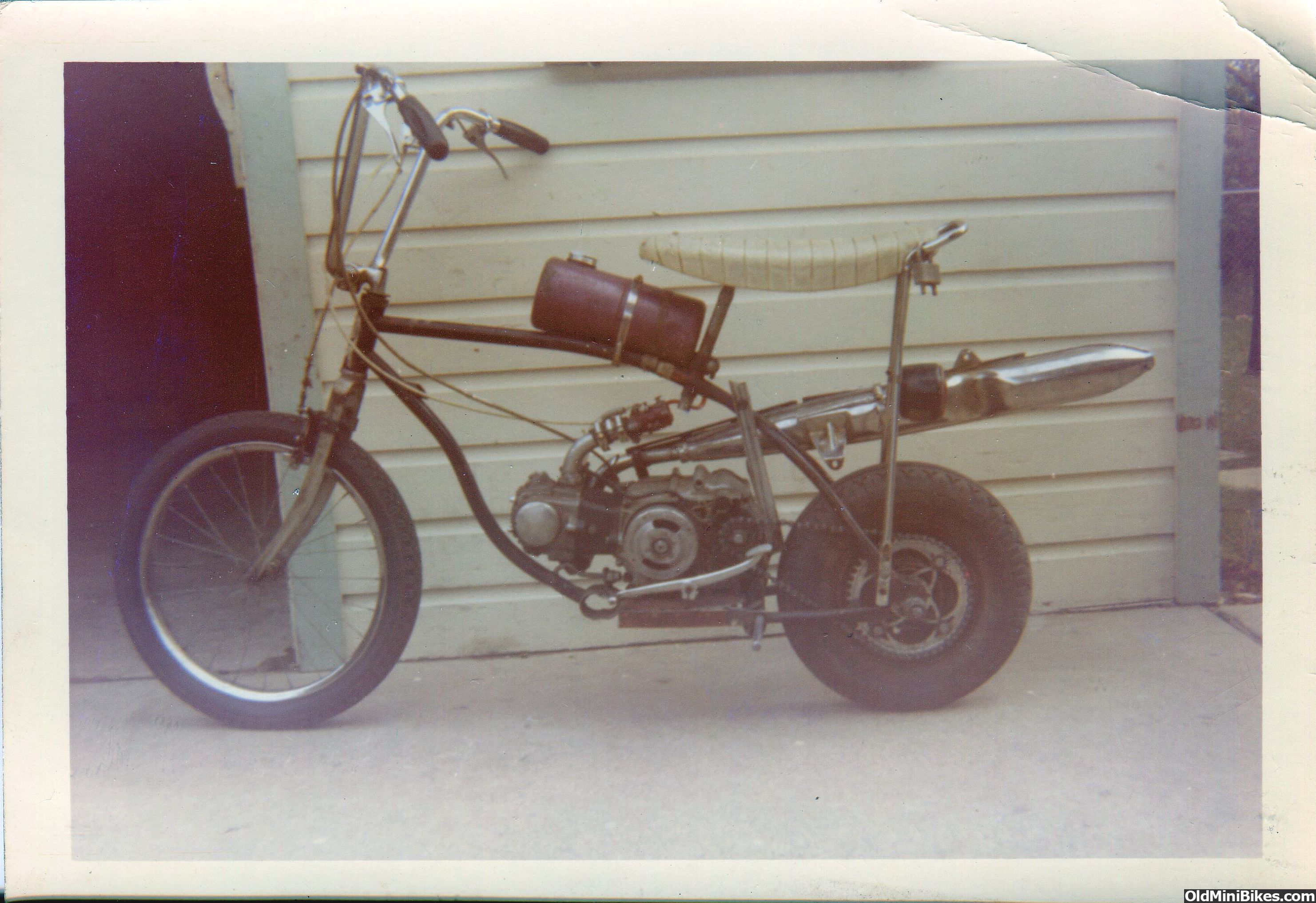

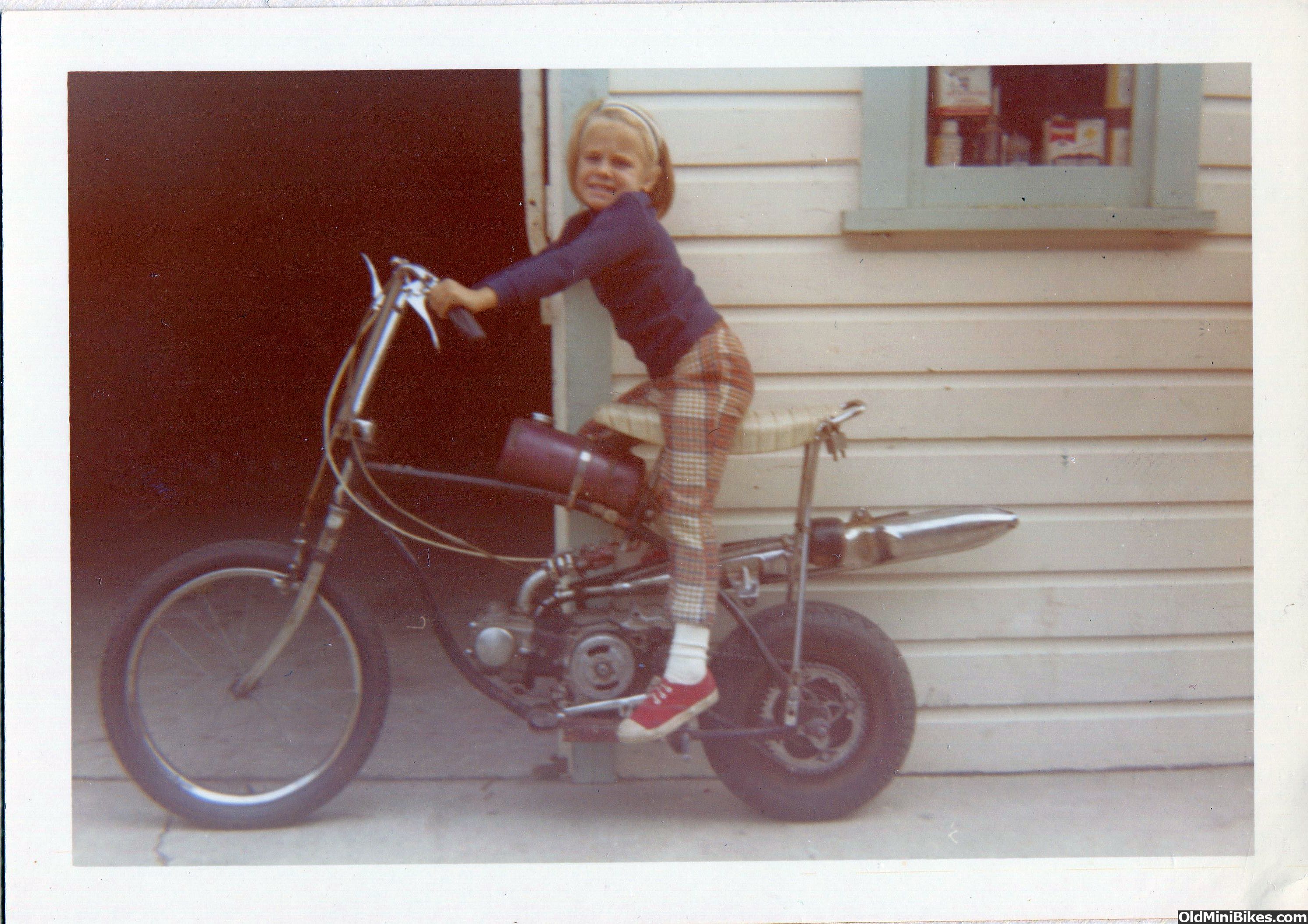

Here are some pictures I found of this more sophisticated "minibike". It had a Honda 65 cc engine/trans I got for a song as it didn't have a carb or coil etc. I got it to run using a diaphragm carb from a two stroke lawn mower. I used an old car engine coil and what ever else I could cobble up. I used a wheel barrow wheel for the rear. (that is my little sister Cindy on it). It had a broken kick starter so it was another push start contraption. Put it in like 3rd gear, Push fast, jump on, pop the clutch.
It was COOL because it had a clutch and 4 or 5 speeds. It wasn't fast but it could pop a wheelie and "burn out" if you revved it and let go of the clutch
Notice the front bicycle brake. Also it is hard to see but the brake lever is mounted on the vertical portion of the high rise handlebars. I used another bike brake lever as the throttle lever! No fancy twist grips for this kid... I didn't have money go Buy anything that costly. I had to use what I could find or get for next to nothing.
I had many hours of fun on this thing.
