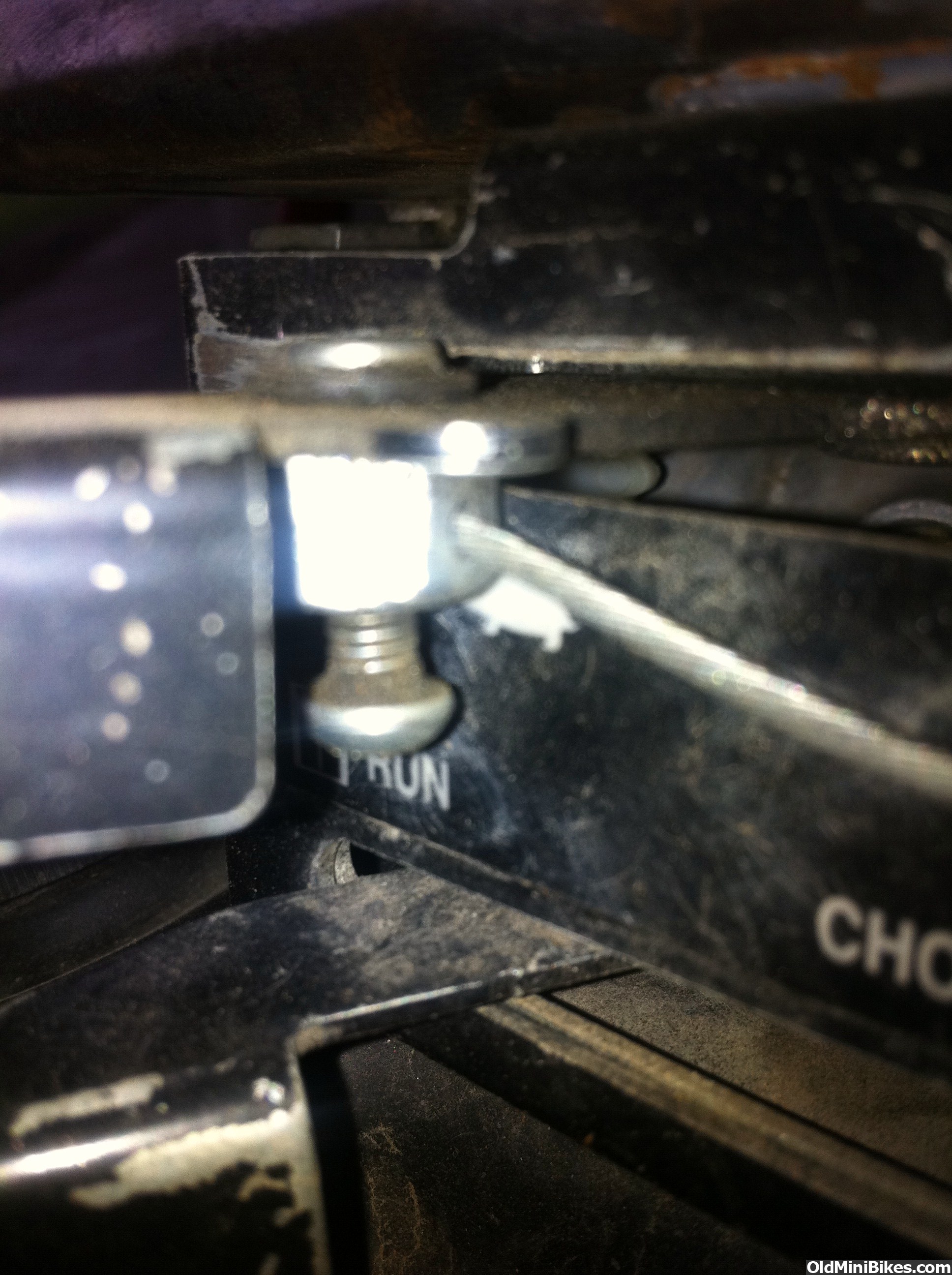

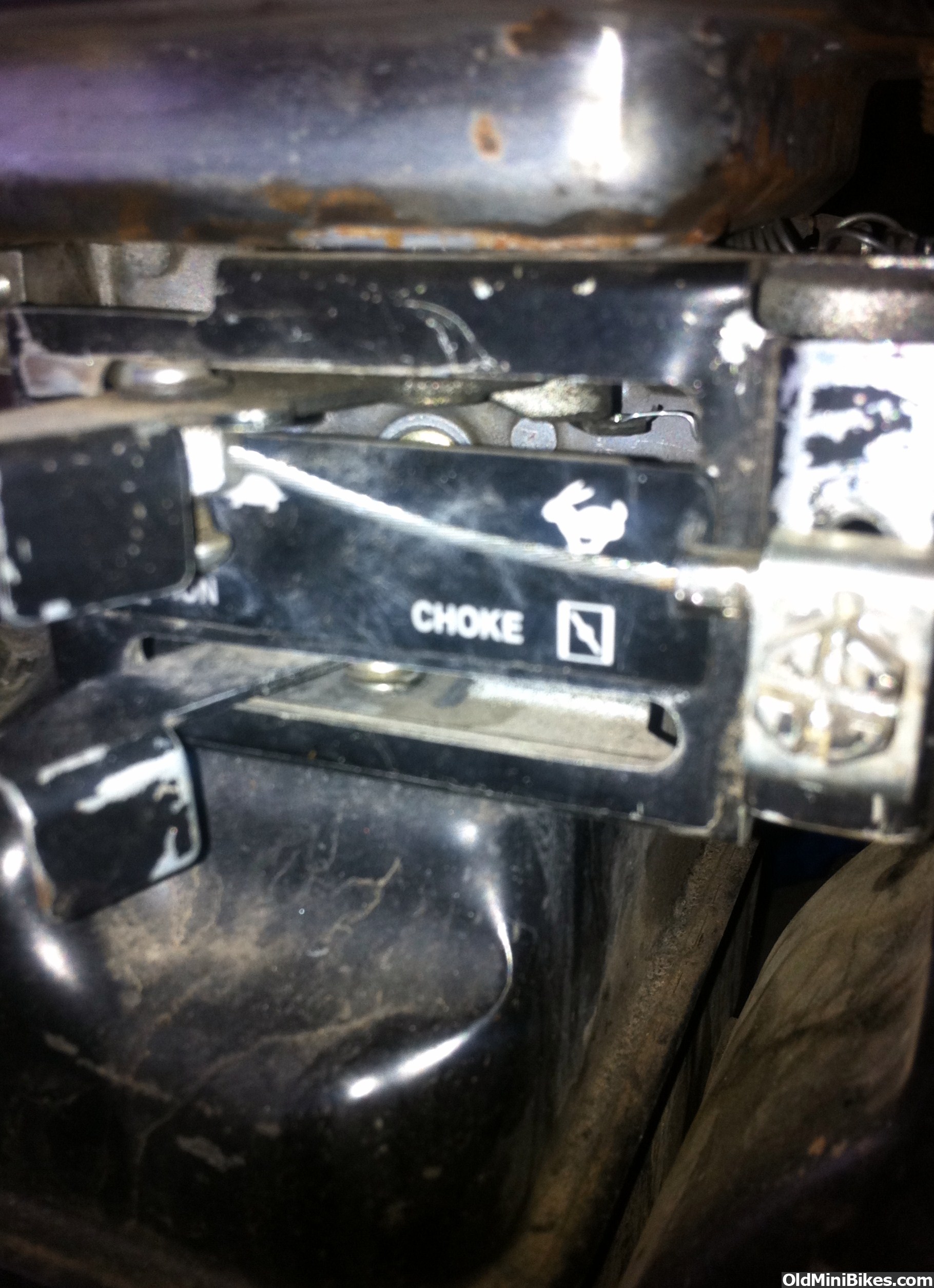

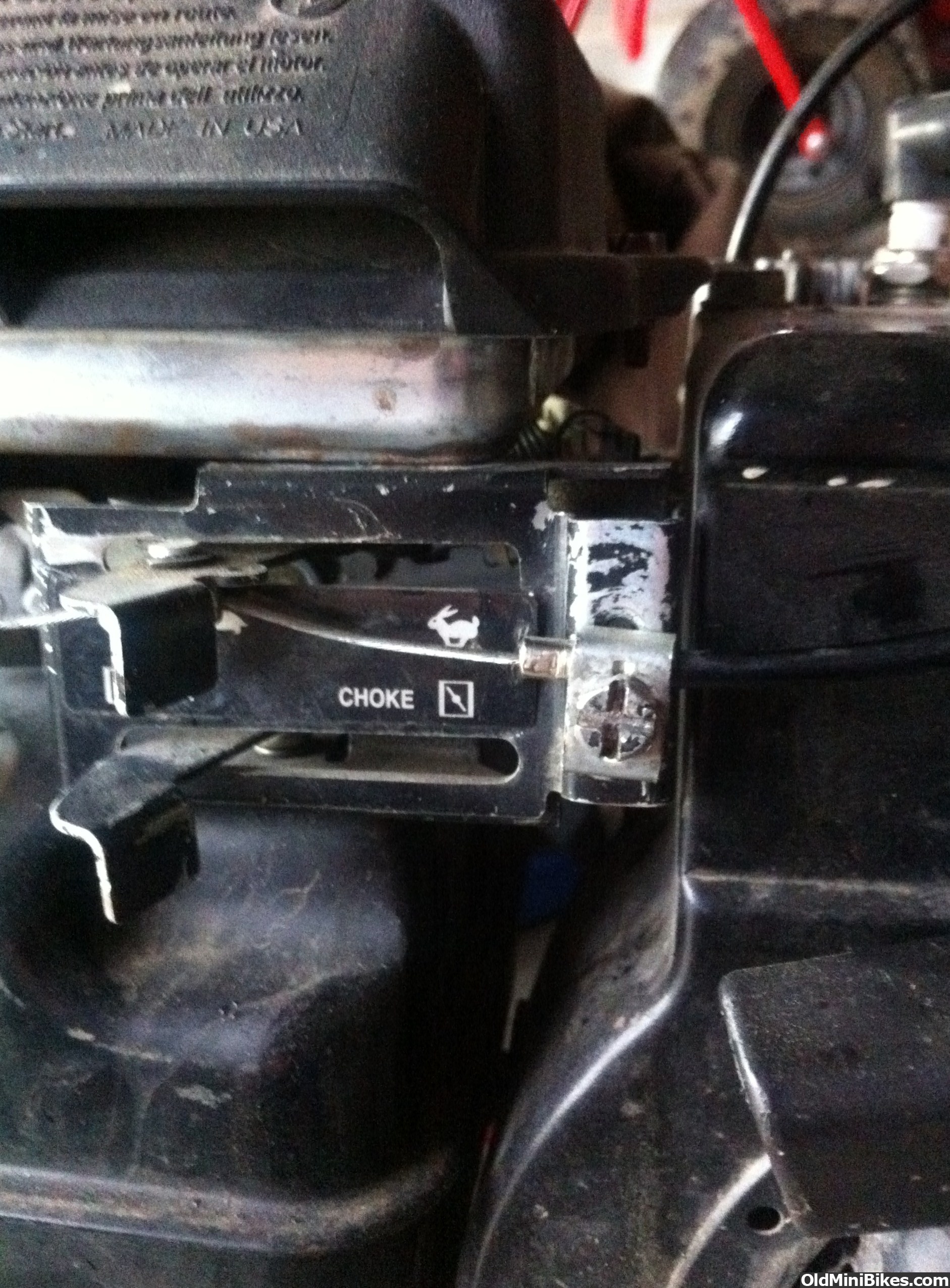

Briggs intek. Can't see it but added a return spring under the tank. Loosened the throttle bolt. Made a bracket and used a bicycle adjusting nut and a barrel nut. Works like a champ

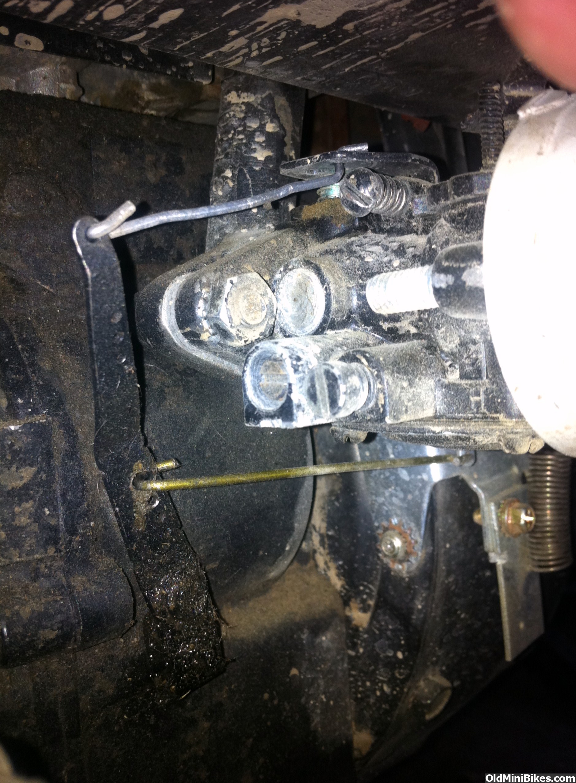

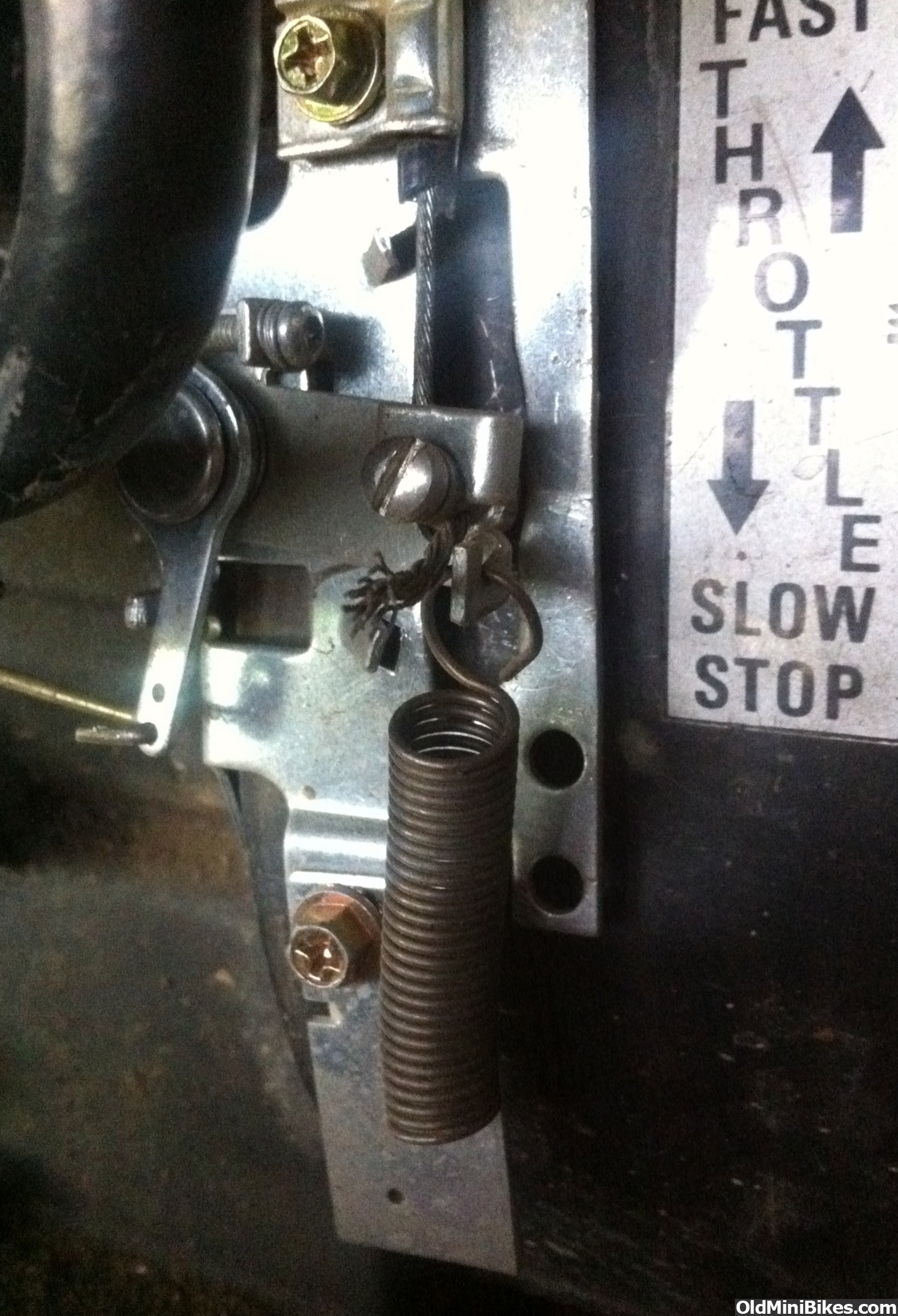

Here's a pic for a 3hp B&S with a Vacu-jet carb. Not that anybody will probably need to see a pciture, but this in the linkage to a 6.5hp clone. Linkage to the 5.5hp BSE on a '72 Moto Skeeter 650. And the last pic it linkage on a 3hp B&S with the Huayi carb from the 2.8hp Doodle bug G100 clone engines.
