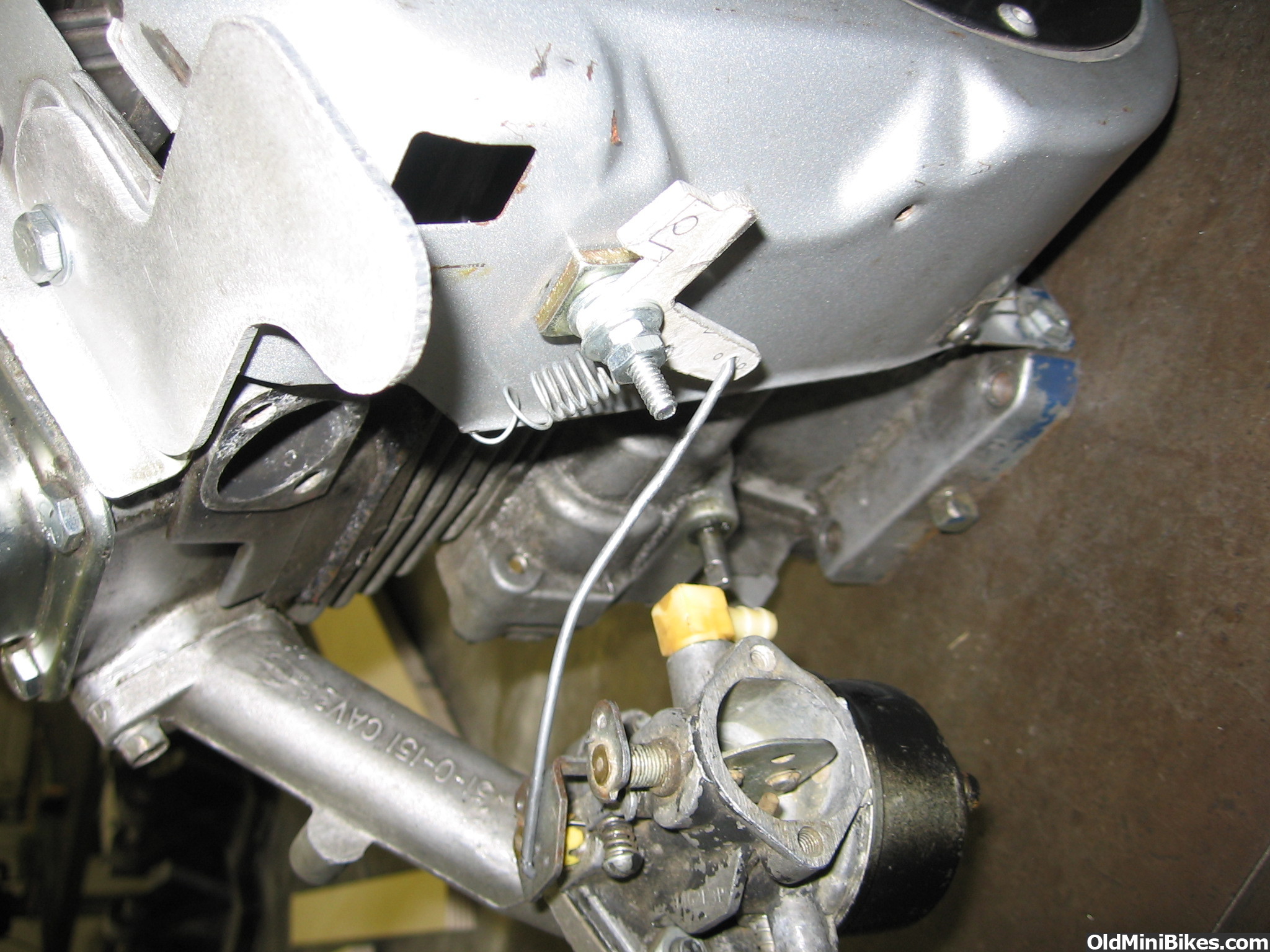

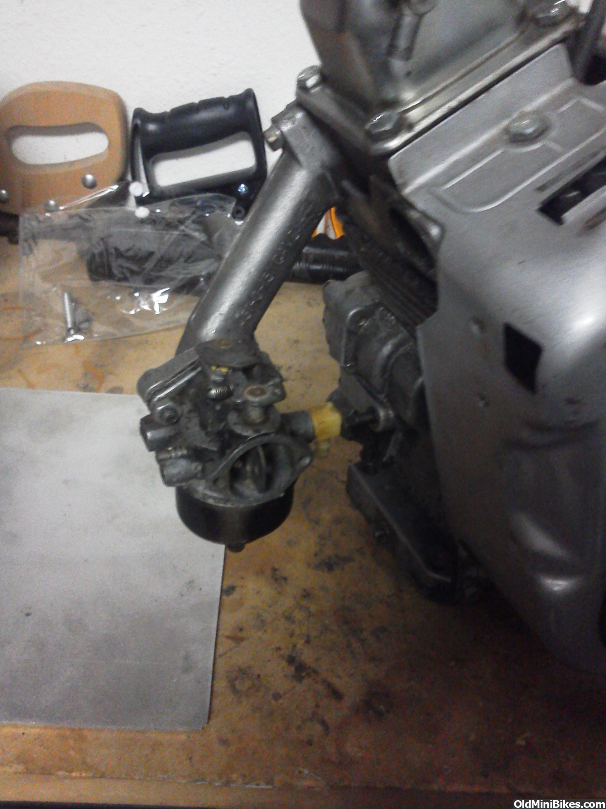

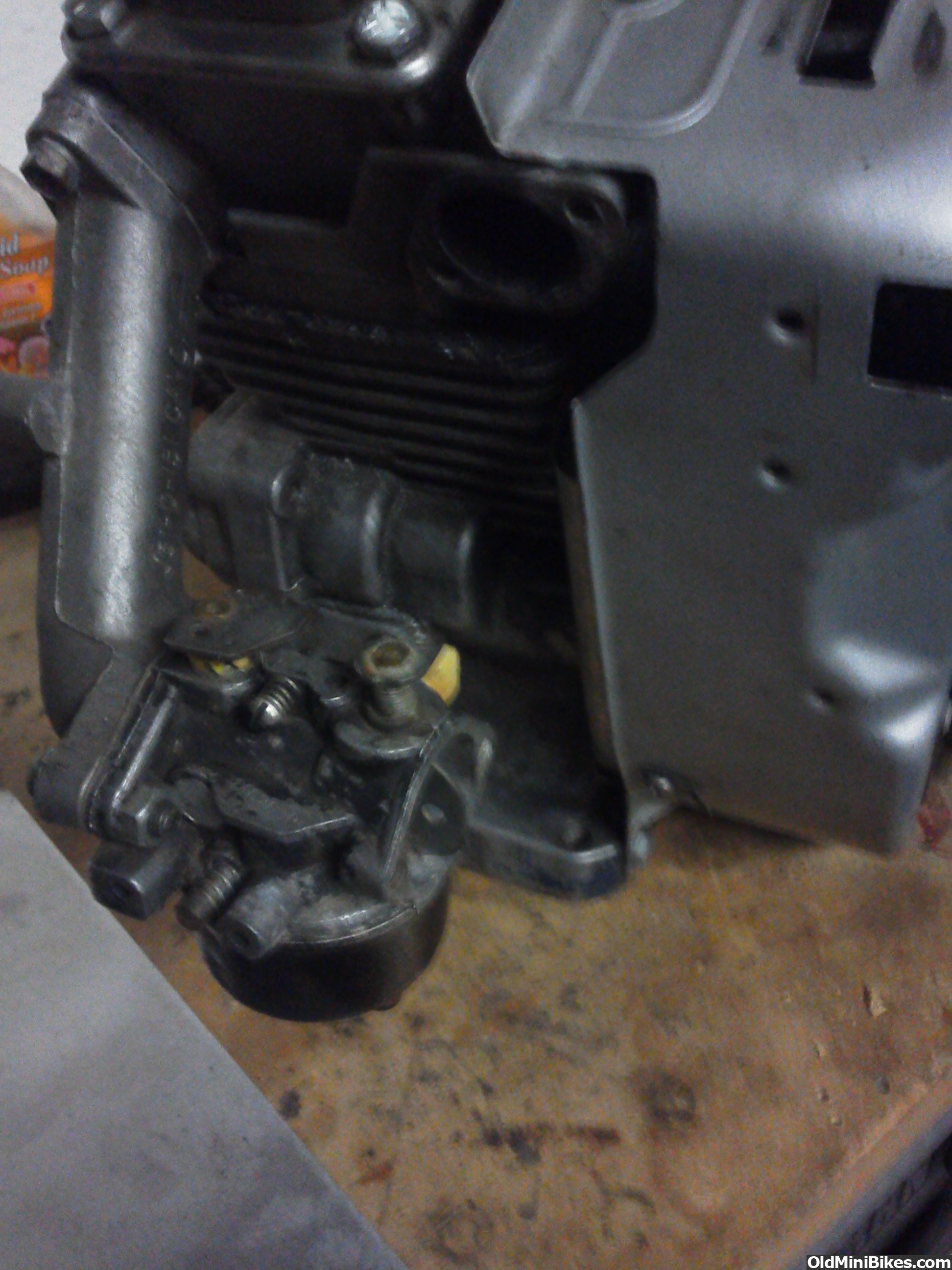

Hey guys was wondering if you could give me any advice on this I need to create my own throttle setup. I saw the thread for the Tecumseh's my concern is i think i might have to do that but flip it to the other side. I have pics at the bottom there the carb is not the original one Previous owner said it was off a 10 hp Tecumseh. Also how could i make something for the choke so its not free and open like it is in the picture. Here is the Link to the Page i saw the throttle set up--> http://www.oldminibikes.com/forum/tecumseh-engines/28110-advice-hooking-up-small-tecumseh-throttle-w-o-governor.html

The choke is an automatic choke. That one looks like maybe a snowblower setup, but usually are on lawn mowers.. You can either swap it out with a manual (if the carb works) or you can just hold it choked by hand until it's started.. OR tie it shut with a piece of wire that unhooks at one end and dangles when you're not using it to choke the carb..

Also theres that carb works backwards, as most of the butterflys on these carbs are (pushed open) by the governor... On the OHV Tecumseh engines, the governor (pulls open) your throttle... So you gotta swap the throttle shaft out or re-engineer the system..
And you're missing parts.. :doah: in your second post, the rotater thing is supposed to pull on a spring, that pulls on an arm that is missing, then that arm pushes a rod that pushes your throttle open..
