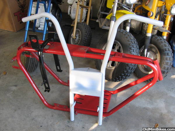

If you look at the brochures posted, TH liked to paint EVERYTHING one color, engine and all unless it was a pimped out model. I'm guessing those were the first 1969 models/brochures?

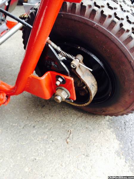

Not to hijack the thread but can you post pictures of the rear brake setup?

I will try to dig it out and get some pics. I am not sure if the snow is icy or slushy where it is...lol. Might take a couple of days.

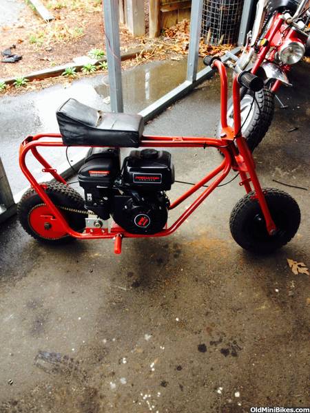

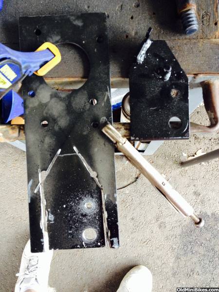

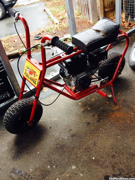

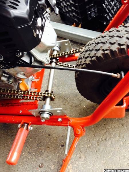

Just tossed it together as a fun rider.... The quick Mcguyver home made left side brake mount is perfect. It allowed me to run the jackshaft. I just used 2 10t sprockets. Not for any gearing but to shorten the chain distance. I had issues on another Trailhorse throwing chains and the jackshaft solves that problem. I still need to add a clutch/chain cover but I just make them out of heavy duty angle iron. I have never found a red I liked. And the pictures make these look a bit orangish I think. But I really like the red this is. I just grabbed some red paint from Harbor Freight that is used for painting car brakes...But it works..I tossed on one of the Vpowerequipment motors I got running and the thing runs great. New bushings and bearings where needed. The front tire is dry rotted but has a tube so who cares....lol. I need to toss on some cheap fenders and a different seat and then on to the next project. The Super Bronc...

Looks great Randy. I like the color.
Awesome!
Put some duct tape on that seat will ya?:laugh:
Or have your wife sew ya a real cute pink cover for it. :laugh:
