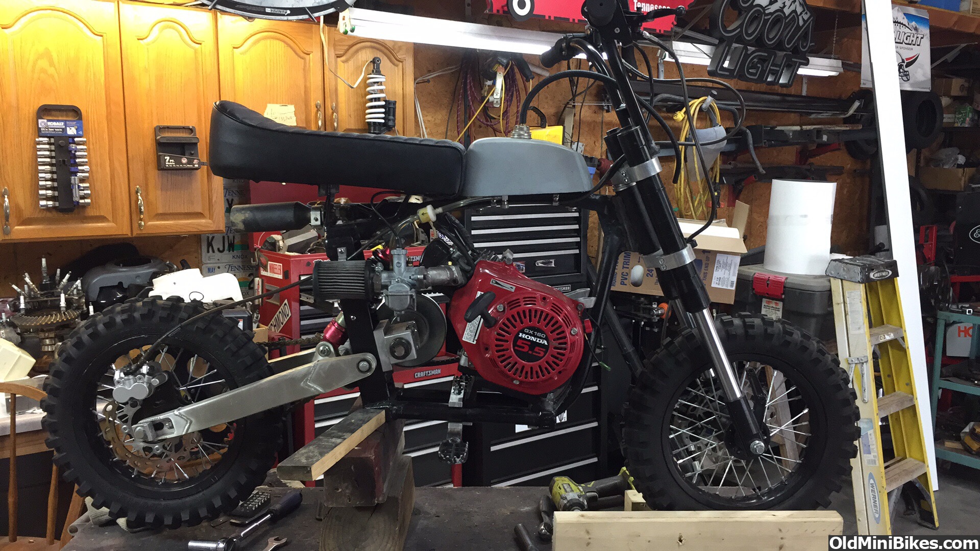

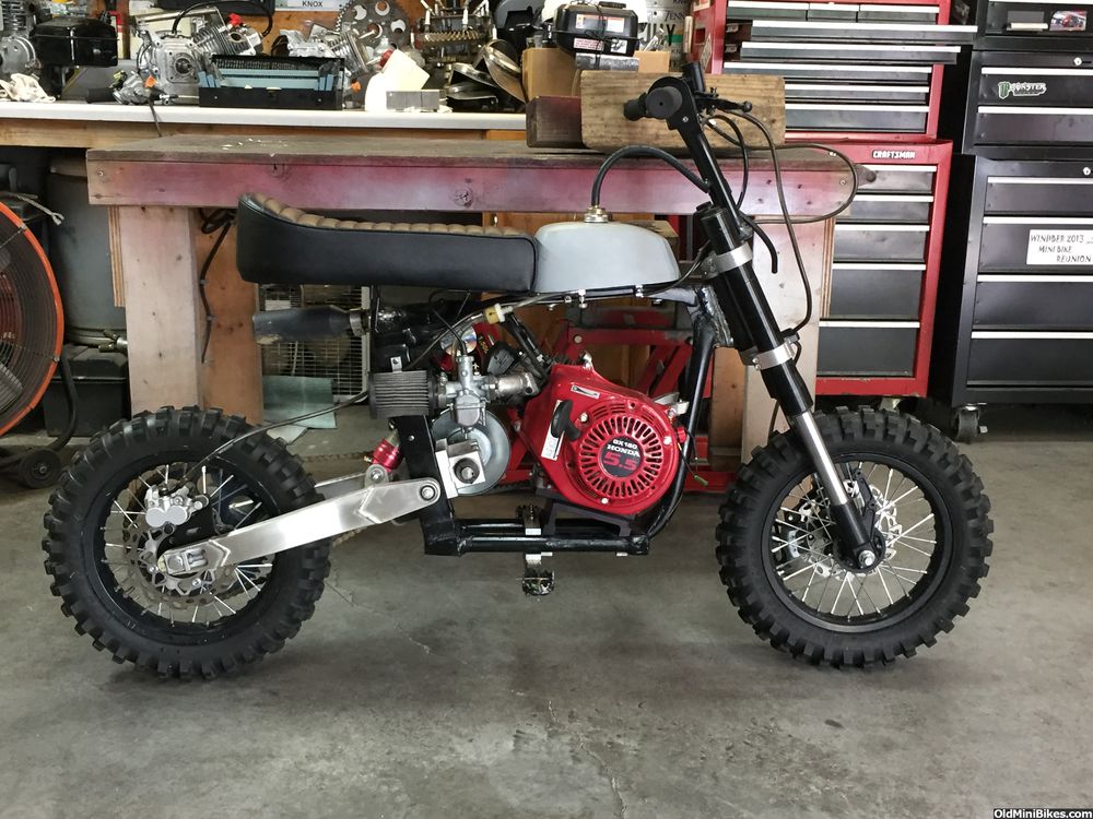

Well I've build a another flat track bike out of the infamous super Powell . I've taken off the Powell frame rails and foot plates . And I've gone with single down tube and still have the kart style motor mount . The foot rest are a one piece design that clamps on just like the motor mount does .
I have my red clone on this bike for power and the drive system is a modified comet 20 TAV , with six inch driven . The driven is locked up ITH a steel sleeve and the driver has a steel sleeve to keep it from closing all the way . What do you get when you do this , a Comet 20 that I got to 8,250 RPM's and is capable of getting a little more with some tuning.
