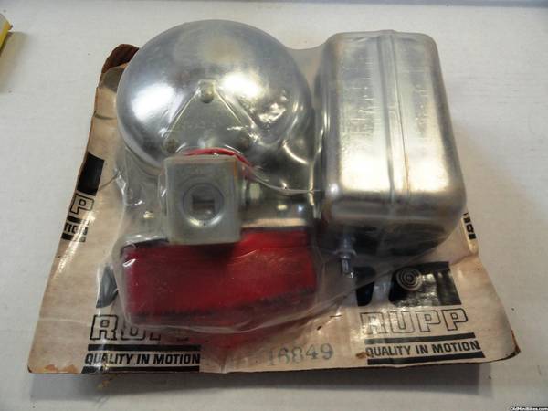

This kit your showing that is a 70's or so later model light kit PN 16849 out of the package. It's completly not a stock item for the 64 thru 66. Notice this has a web type mount on the back of the headlight. The headlight is completly re-designed in the later model and they done away with the old dual battery system to a single battery box system - it does look like it has a nice chrome box though... Impressive light kit I think !!!

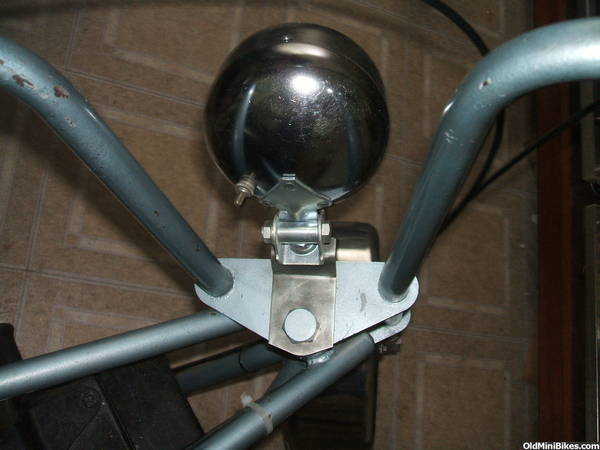

Now this is the correct headlight for that era 64 - 66 it has a different mount that requires a small solid metal square stock drilled out in a T pattern inside of it to mount with and utilizes the Rupp factory pre drilled small hole on the top front fork triple tree plate and a little bolt goes through it and screws into the square stock light bracket as the following photo's show.

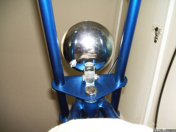

Now you can note how the later model mounts with a mounting bracket that's held on by the neck bolt. You will also note that the headlight switch is mounted optional small battery box in the above photo's.
What's trick about these headlight buckets are is the 4 in 12 volt solid glass headlight bulb fit's in these with no problem at all - so those of you that have 12v charging coils in your motor you can run these headlights...

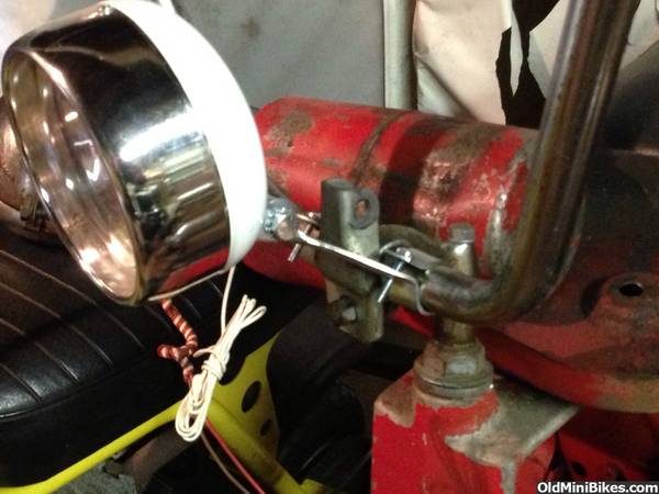

Note the headlight Levit electrical light switch was installed by me into a more modern headlight housing with the flat plate mounting bracket so that's not stock for my other Continental bike I have - but running dual batteries I had to install the switch into the headlight housing. Anyway it's completely wrong for my 1965 Rupp - I'll take it off because I found another correct light for it not long ago.

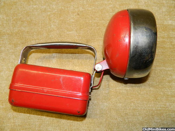

and someones Scatt Kitty with the Cyclops headlight mounted so it was a very universal light kit - the headlight even shows up on the late 1950's era Ray o Vac sportsman 6v fold away lantern - does that "Headlight" look familar.

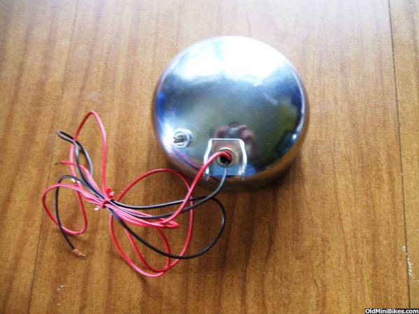

Here is what the battery box and headlight look like but not the tail light for your bike.
Rupp Blackwidow minibike mini bike headlight kit
