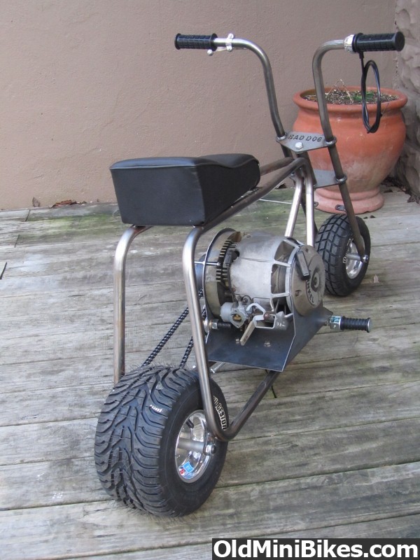

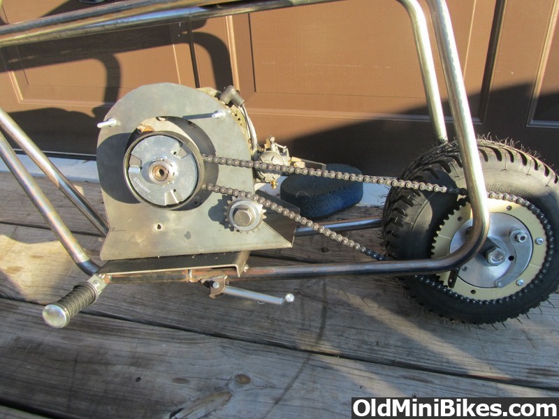

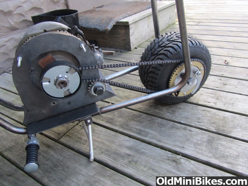

Got chain done today, I was gonna put idle sprocket near rear tire but i think it looked better and was eaiser putting it on motor mount. next is carb and exhaust. I order some cool detail stuff for it today. Bolts that hold motor are temporary , they are missing one and are wrong size . I got my locktite just waitn for every thing to line up..

good choice on the idler location, lookin' good. :thumbsup:
do Wankel engines have a lot of vibration? the mounting plate just looks really thin, but I dunno I've never messed with a rotary. does it bolt in on both sides? :shrug:
EDIT: OH I see what you did, sneaking it in between the pull start, clever :thumbsup:

yeah i think i bought 14 or 15gauge steel. when all bolts are in it felt sturdy. ima weld little supports inside of mount. as far as vibration on start up and when i shut it down its got a little compression shake to it but at idle, other than wanting to rotate it has very little vibration. I wish in new hp I did several hours oline and could not get a true hp amount.
