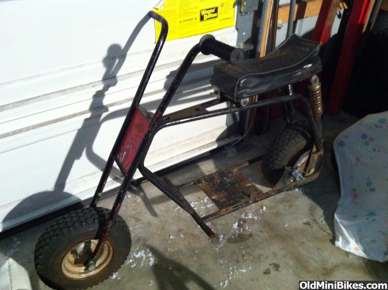

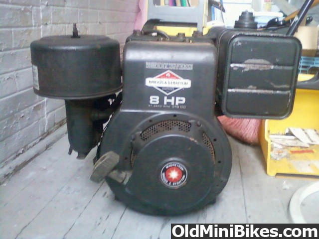

I'm gonna make a drop bracket for the tank......Juuuuuuust low enough to lube it up with "Crisco" and a "shoe horn" and get er in :laugh::grind:
#16
YOU WILL HAVE TO put a jackshaft in the bike.. There is no way on earth you'll ever align the sprockets.. even if ya bought 100 dollar clutch to fit the motor, getting the chain lined up, will leave the pull rope side hanging out about 3 feet out one side... Even with the motor centered nice, it will be so huge you'll have a hell of a time sitting yourself around it, and find any place for your feet.. If ya hang the tank any lower, gas won't flow to the carb.. if ya lower it 3 inches, you run out at 1/2 tank.. lower it 5 inches, you use 1 inch of gas tank, run out with 5 inches still in the tank..
If ya take tank off, mount it on top of the frame, center the motor best you can, then ad a jackshaft.. It could all be done... It'll take some doing though..
