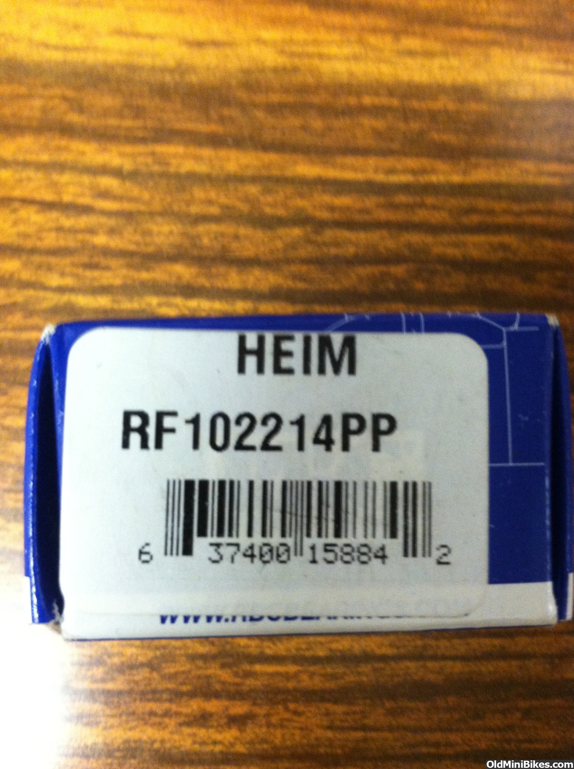

The radial bearings with the flange don't use spacers. If you use regular ball roller bearings, like the snap ring bearings without the snap rings, or high speed bearings, you need a spacer. If you have the old original flanged bearings, and ride a lot , they just don't last long. With those, overtightiening causes it to eat on the "cup" on the inside.
