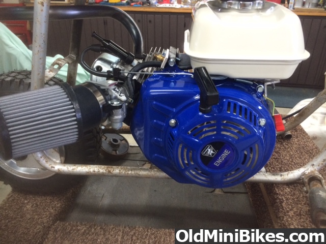

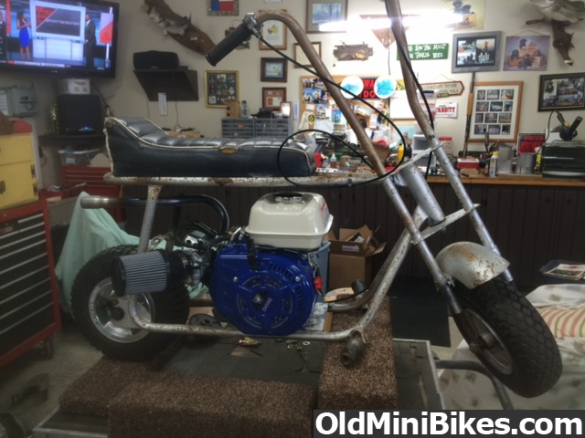

Got the engine finished over the weekend, break-in done on the bench and it is now on an old Cyclops frame. I took it for a spin Tuesday. Motor cranks easy, runs good and I am just using as a cruiser, so I am going to try not to break it or squeeze it to the max. Appreciate your input. I used a exhaust retainer and lash cap on the exhaust and intake valve. Had to make some mount adjustments for the gx-120 low profile tank, but it worked out good with an old style flat fuel cap.
