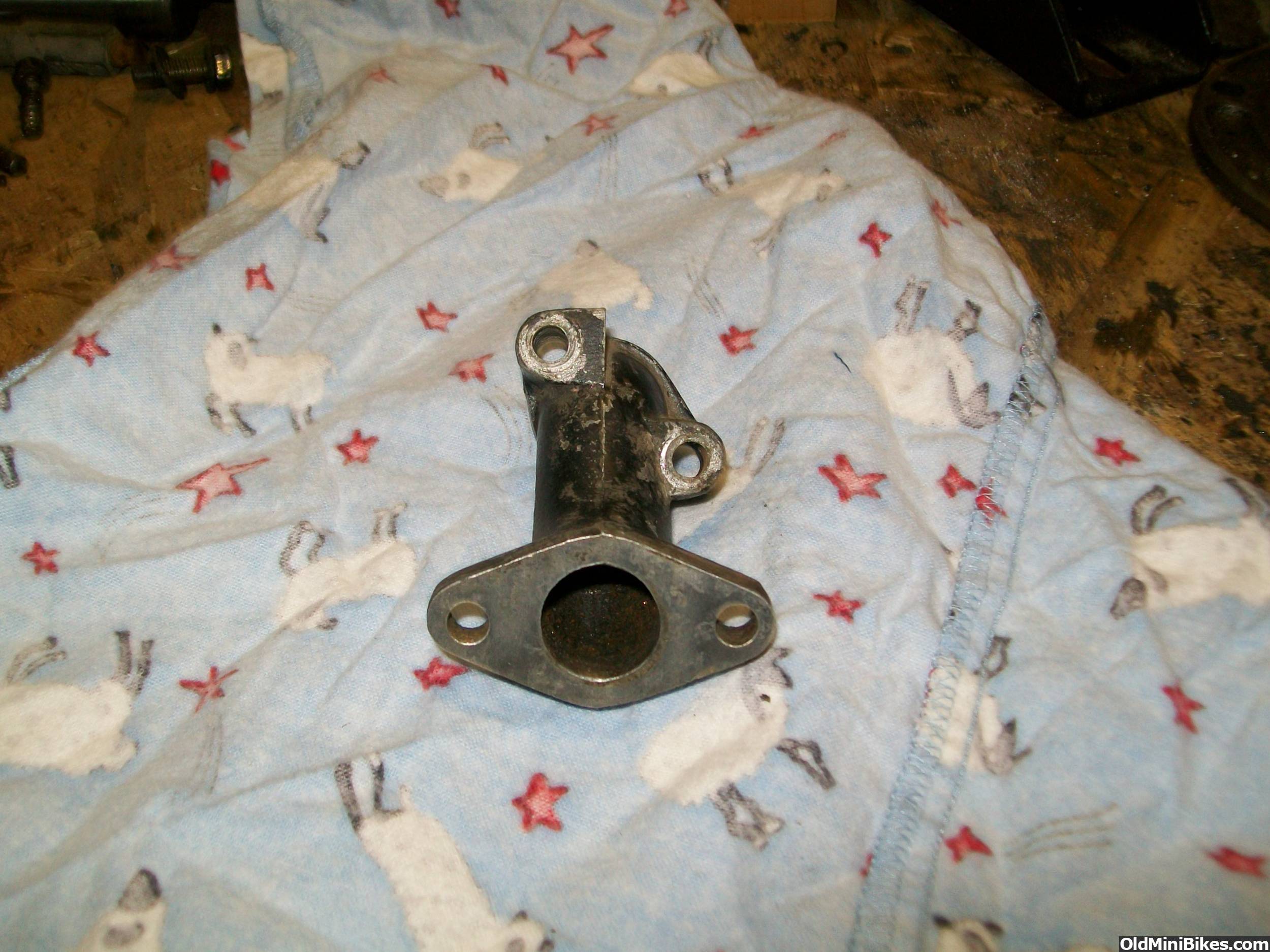

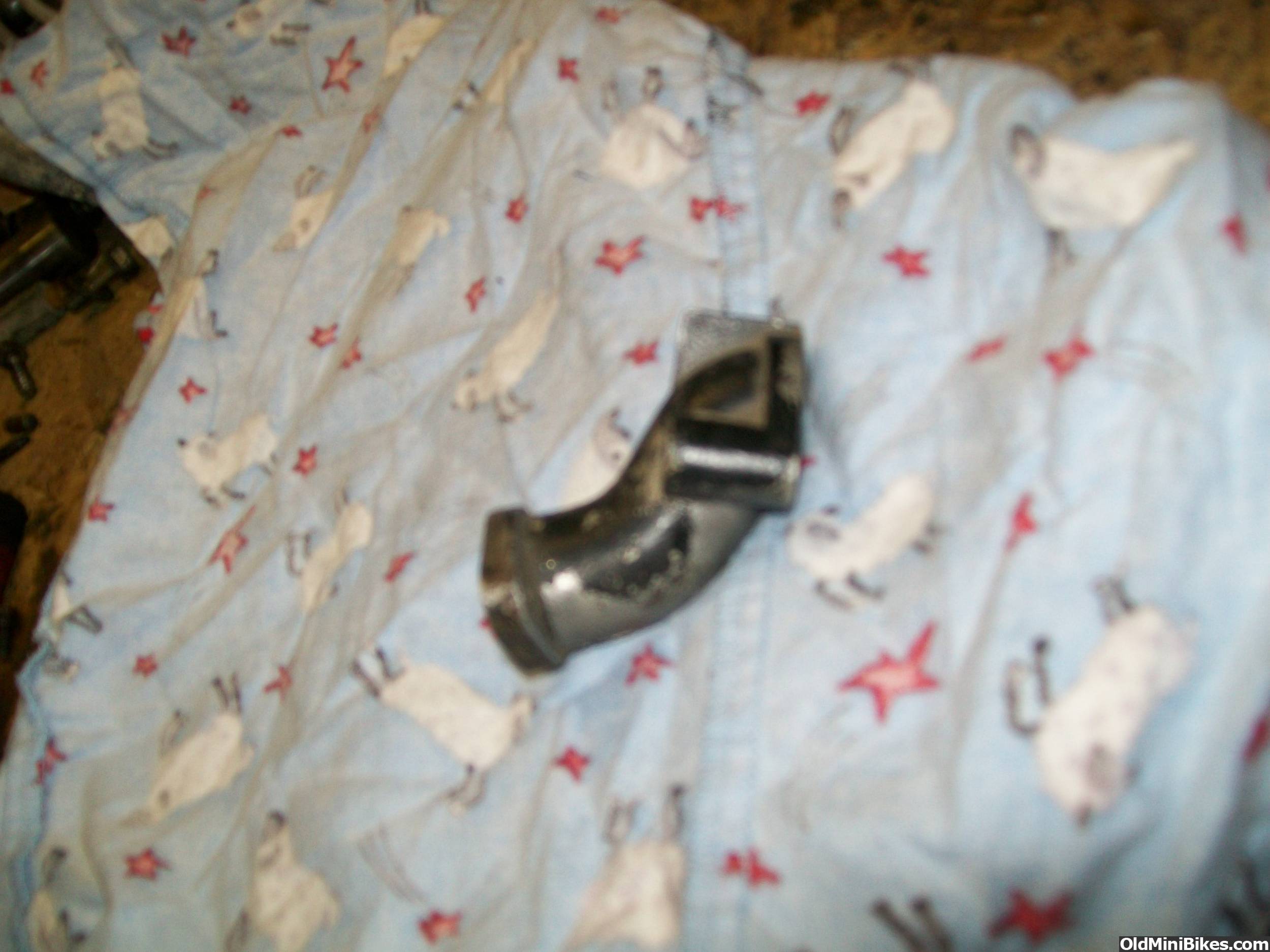

3.5 tecumseh slanted intake
125ccCrazy
I know it's sold but is that the intake that can fit on a briggs 5hp flathead and a 22mm mikuni carb set up?
bolt holes line up with a briggs block but the intake will set the carb on too much of an angle side to side and No the mikuni won't fit... a real VM22 has a wider bolt pattern and the taper bores have too big of a bore plus the bore is lower center to center with the bolt holes causing a major air leak bewteen the carb and intake....
