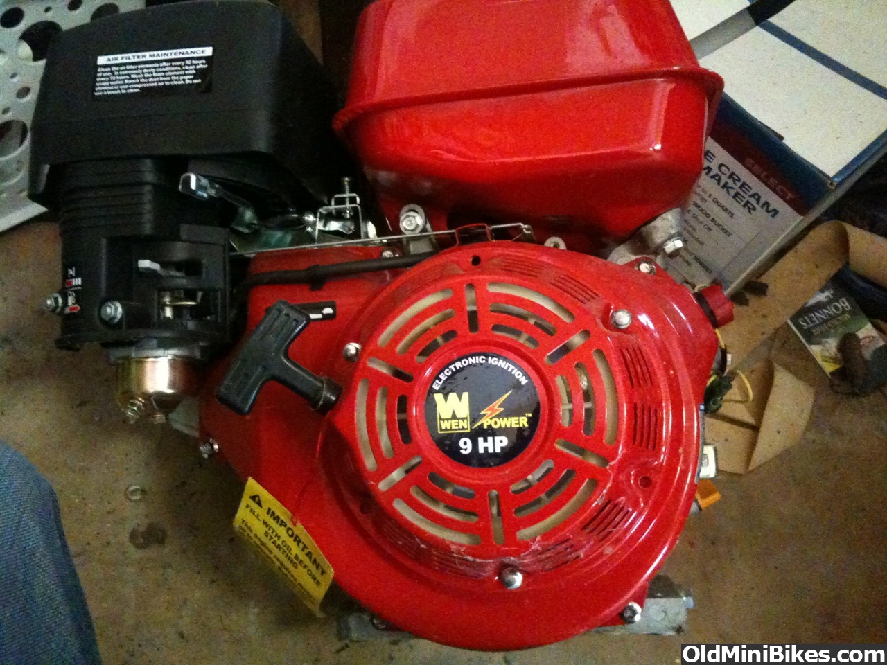

well did some looking..looks like i can get a 10 tooth drive and a 72 rear...That should pull a hill rite? might be kinda slow but the wife doesnt want to go that fast anyhow... I will put the 9hp on mine. HAHAHA
