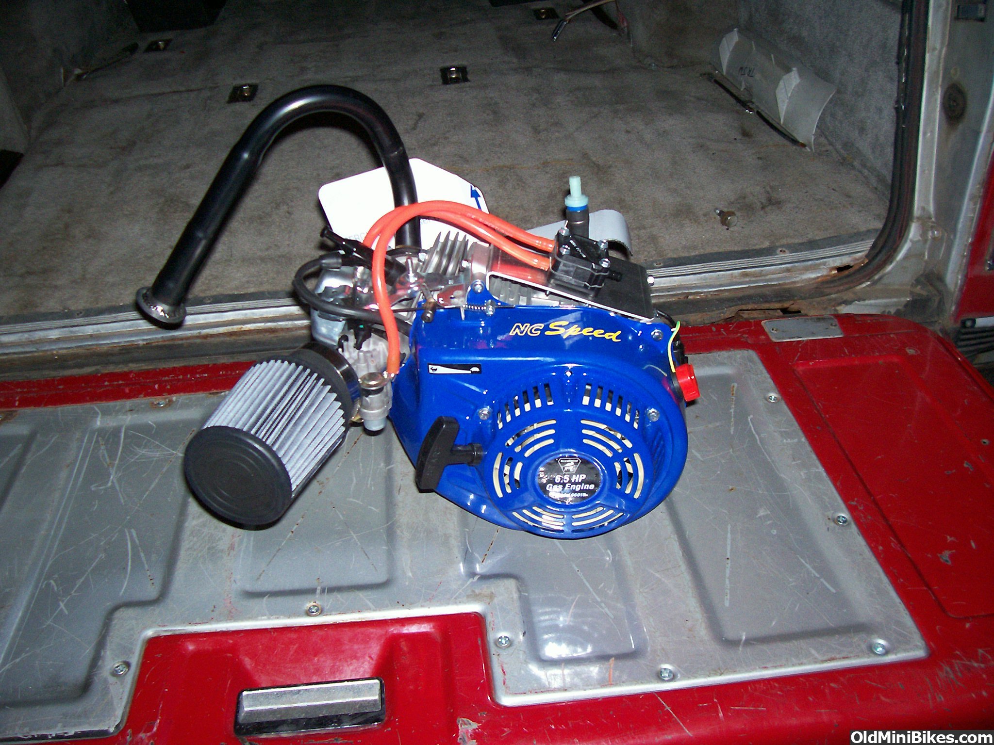

NR racing stage 2 build (no governor, 18 lb Valve Springs, Small fan, Advanced Timing, Rejetted and bored carb, 1.2 Rocker Arms and a race prepped & milled head) Aluminum flywheel, external tank, UNI filter and header

#6
How good does it run? Im kinda thinking thats exactly what im going to do to mine. I saw on the site that its only supposed to put out like 9.5hp but I would think it would be more like 11. They put out over 9 right out of the box with just header and filter.

#7
Runs like a scalded dog. This motor has always started up and idled perfectly with plenty pf power. The stage 2 says 10-11 HP on this site and 5500RPM but I have seen 6000+ rpm so I know they under rated them.

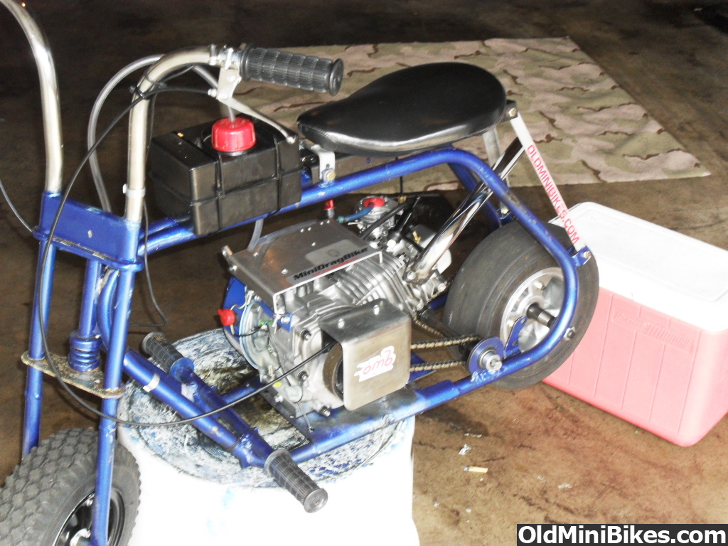

#9
Nice scooter man! I noticed you have a band brake on the clutch. Would you happen to have a pic of how you mounted it? Prob off the OldMiniBikes chain guard? That looks very clean and cool. :thumbsup:
