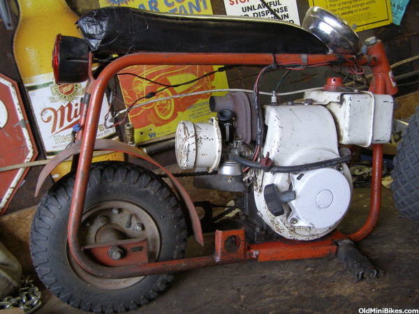

I got this little guy over the summer. Fox Doodlebug with original paint and engine (mostly). Here it is right after I bought it:
The good- original paint, seat, controls (throttle/grips/brake lever), sprockets have minimal wear, original front decal, clutch cover and disc brake, light coil motor (works:thumbsup:) and best of all it RUNS:smile:. Out of all the bikes I own only three of them were runners when purchased.:laugh:
The bad-the motor has been short blocked...the block is dark silver and the tins are white. This is only bad purely for aesthetic reasons, it actually runs very strong with plenty of power and no smoke. The air filter backing plate has been changed. The recoil has been spray bombed (poorly) and has a Briggs handle. It has an ugly red plastic gas cap on the cool steel tank:no:. Dig the white brake cable. They really had the red/white thing going:laugh:. The front fender is missing. It has the high speed fork option:doah: The previous owner replaced the carb with a brand new one, but it's the wrong carb:doah:, it's for a big block and the damn thing runs way too rich.
So the plan is to "just clean it up"..........:blink:

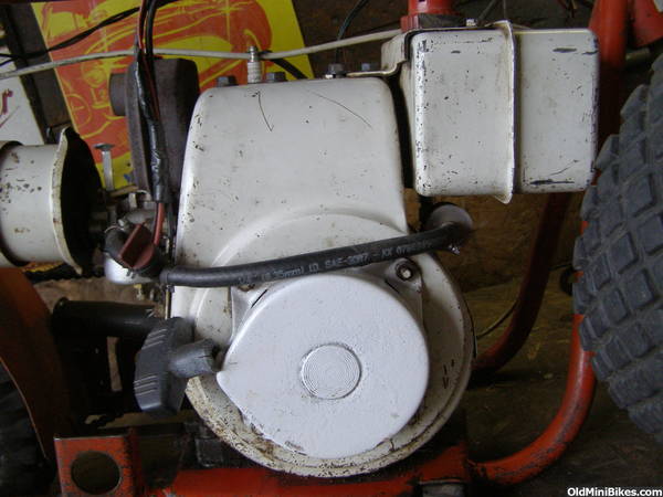

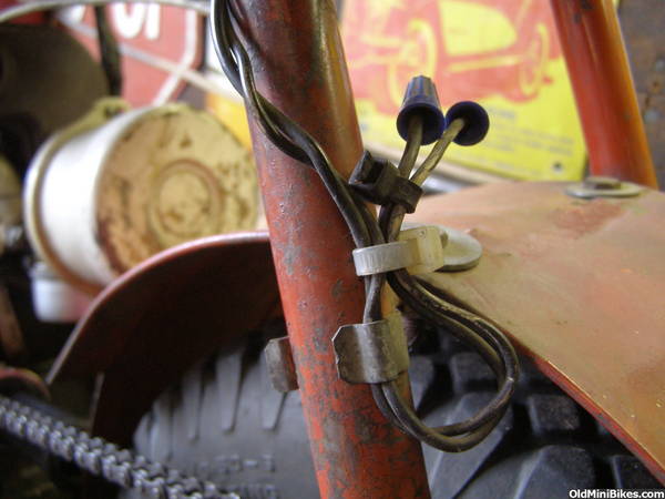

Check out the horrible paint on the recoil, and the jacked up wire harness...
Ah, the famous "package"...

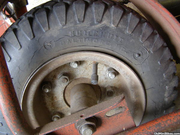

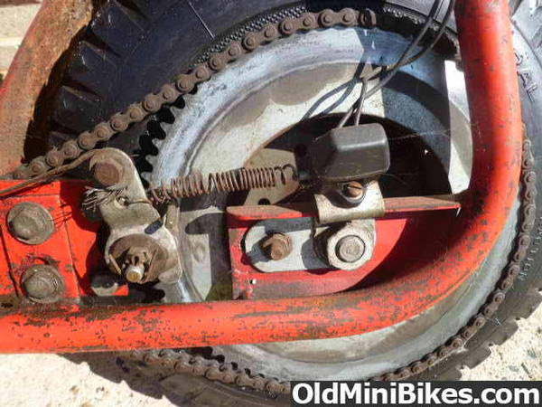

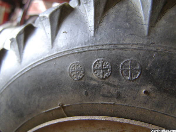

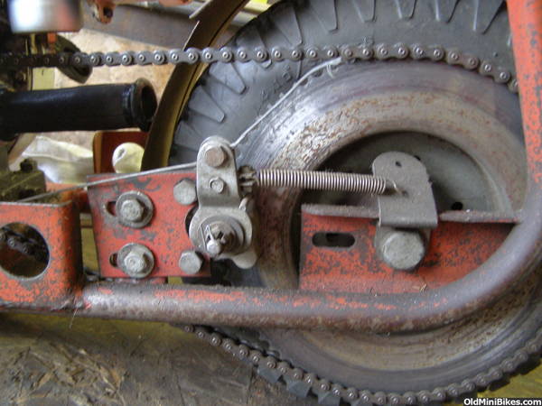

This bike is supposed to have Good Year tires on it- looks like someone changed the back one at some time. Although there is plenty of tread, the cracks will not do:hammer:. There is no evidence of the rear chain adjusters, either....
The front has the right tire.....
However, upon close inspection it is cracked as well:doah:

That's what I need. Rear chain adjusters.
The Sprite frame is simular in the rear. And they seem to have the same rims and hubs.

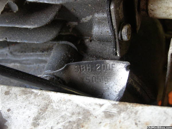

Anyone know how to decode this? I know that SBH stands for Short Block Horizontal, but that's about it....

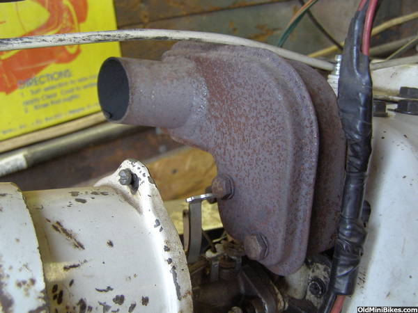

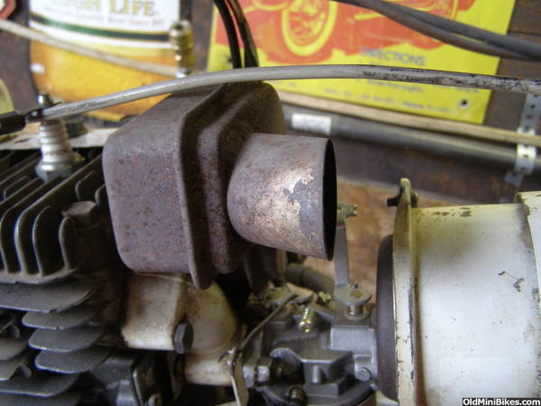

Check out the muffler. looks like a stock snowblower type, but with a short piece of slash cut pipe welded to it. Still has remnants of the white paint on it:thumbsup:
