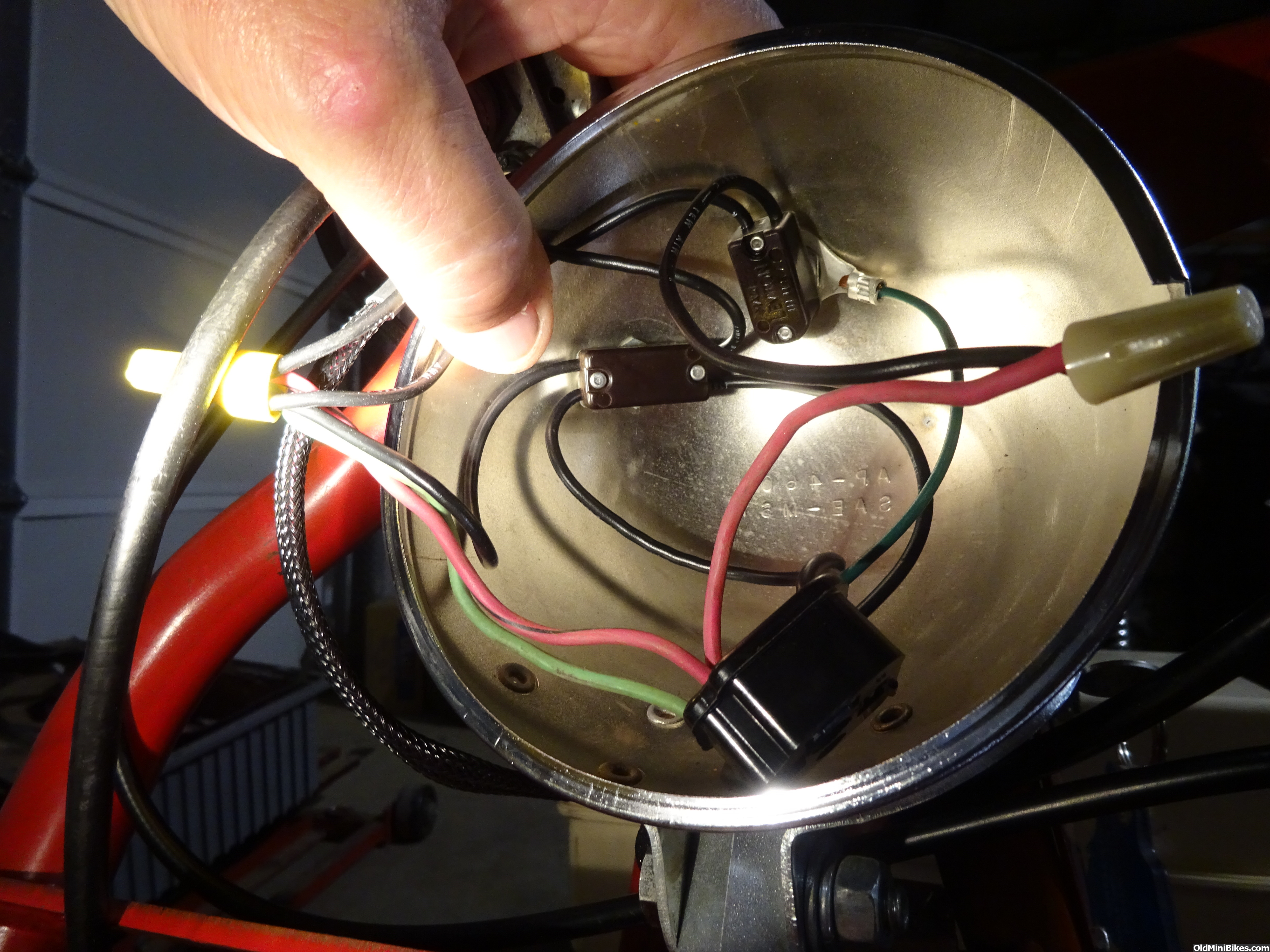

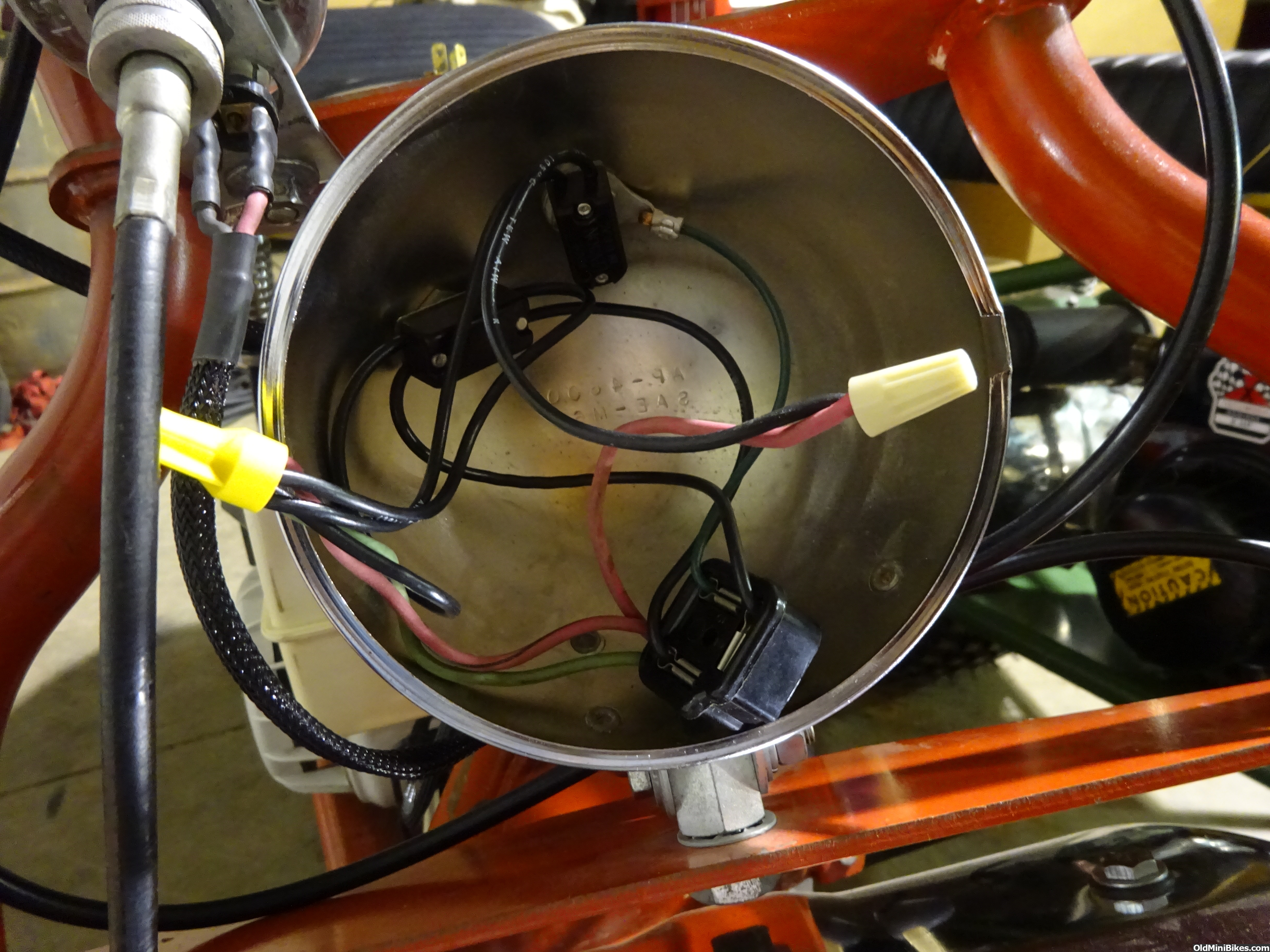

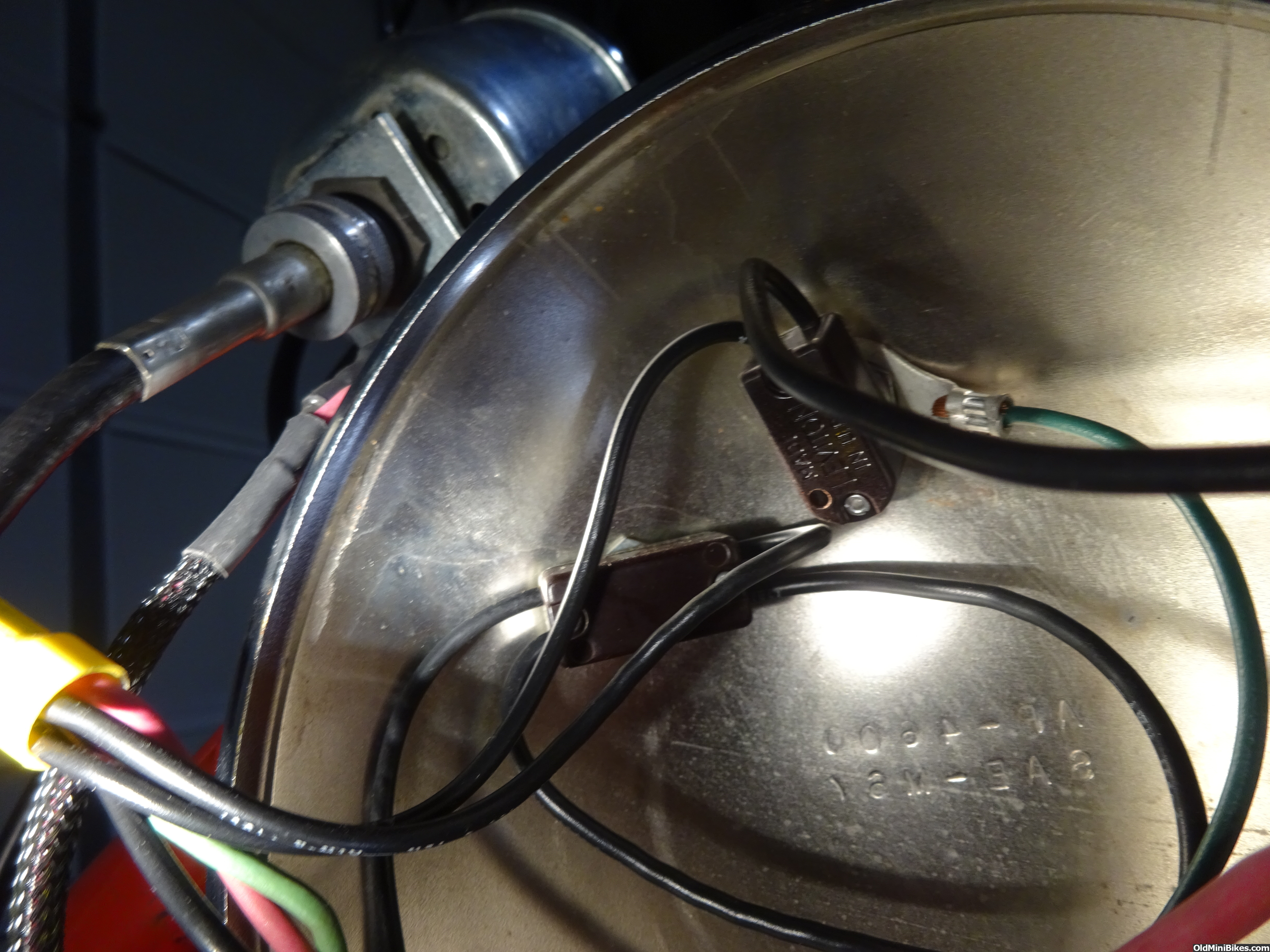

Here are the switches and wiring. They are Leviton switches. The solid red wire going to the white wire nut is 12 volts to the on/off switch. The green wire is the tail light and the red wire with the black strip is the speedometer light.
