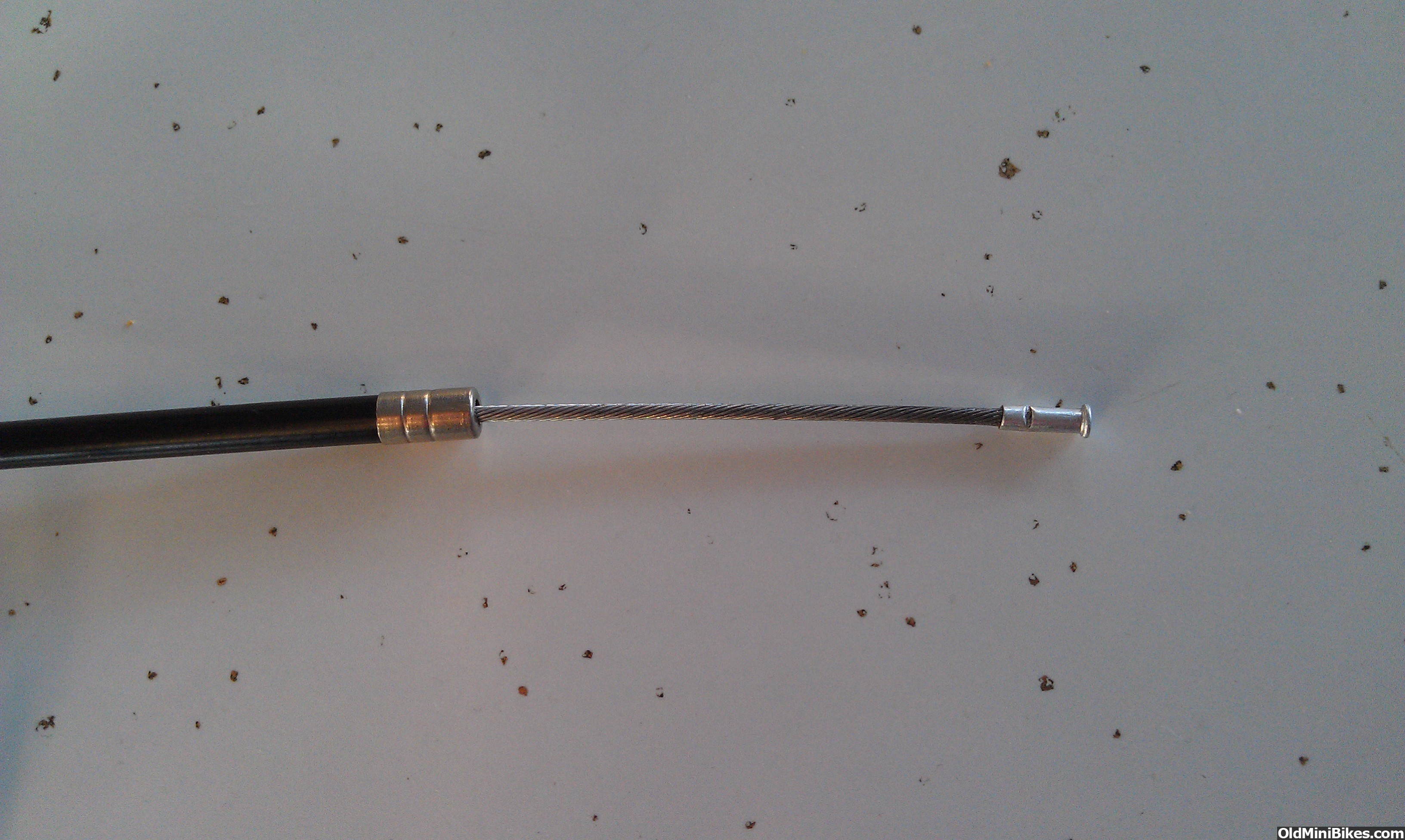

If your cable is overall to long cut the ball end off, pull cable through and cut the housing to the length you want. The silver cap can be removed by heating with a butane lighter then reinstalled by reheating. To keep the wire end from unwinding yes you can soldier it. Doesn't always work but yet to fail for me. Just use alot of flux. If the build up is to much I very carefully grind it down. You can also increase the size of the hole for the cable stop. Also the cable ends can be used from bicycle cables, which I recycle all the time.
jrzmac
Active Member
#16
yes, the solder trick does work. doesn't take a lot, just a dip in the flux, a tap with the pen and a tiny bit of solder. works every time.
go from this:
to this:
