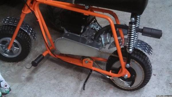

Can somebody show me a pic of how they mounted the OldMiniBikes 4-1-2 style brake. I dont have a cable and can't seem to figure out if i did have a cable how it works it just rotates around.
You would need something to keep it from rotating. Azusa supplies a clamp to go around the lower frame rail. One of the bolts is long enough to intersect the "fork" on the drum and keep it from rotating.
Not a great close up but you can see the rod coming off the frame that the fork goes over and see the eyelet on bottom side of frame for cable attachment , good luck .

That bike originally had a scrub brake , so all you see I made and welded on the frame , the idler / tensioner wheel was also added , I made it with a skateboard wheel , I turned it on a lathe to cut a groove in it , It's not needed but makes life a whole lot easier , one bolt to loosen , slide it back a bit and chain is tight again !! not sure what lever you're talking about ? the arm that is on the drum brake ? if so I guess you could make one ?? good Luck
