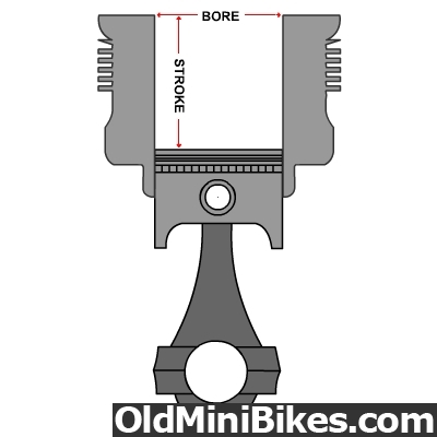

From paperwork in front of me I see that a 2HP Briggs is 2 3/8" bore, the 5HP is 2 9/16" bore, the bigger block 6HP is 2 3/4" and the 8HP is 3". Not as much of a difference than you might think....
The stroke of a 2HP is 1 1/2", the 5HP is 2 7/16", the 6HP is 2 3/8" (less than the 5HP!), the 8HP is 2 3/4", so greater spread there actually...
