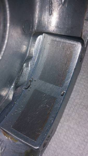

Broke down the red '68 bee sprayer Tecumseh today and boy does it look good inside. I was told it was used once and put away never to be used again. He was not lying! The inside of this thing is so sweet! The cross hatch pattern clearly visable too.

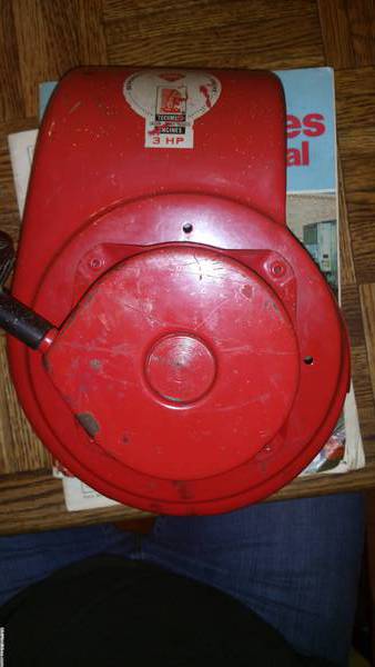

It has a riveted pull cord housing.

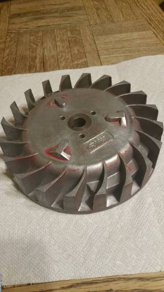

Looks like GOLD Johnny, glad you got the fan off :thumbsup:

That was the nice thing about the pre 1970 small frame H engines....the steel sleeve :thumbsup: they seemed to dump the idea in 70, even only offered the aluminum bore block as the replacement block for those after that.
