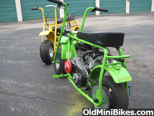

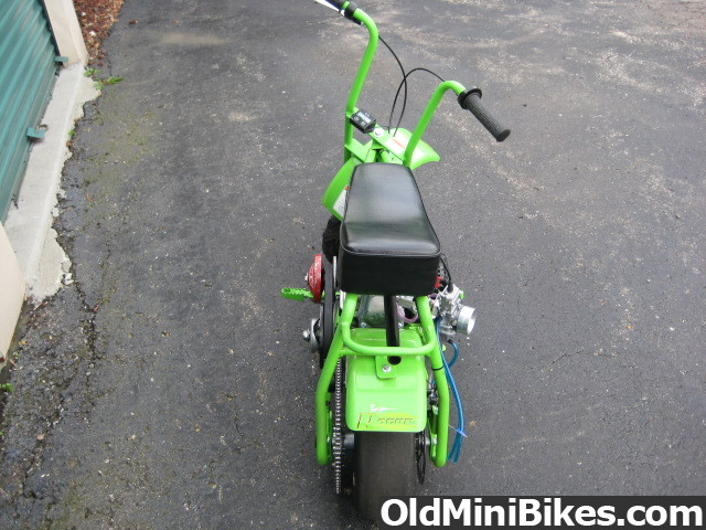

DB-30 1/8 mile drag bike just about done

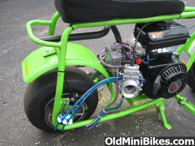

Here is some pictures of my 17+ HP 6.5 clone hiding behind Predator pull start cover and small gas tank.
About to add my front skinny rim and tire tomorrow to

What rear tire is that? My friend and I are building him a drag doodle and he wants a slick that's about the size of the stock rear tire, and that one looks about right.
#6
I bought the motor already done that was built by stoney creek racing in Belleville Mich,it was a alky motor before and I convert it to gas.Its high compression equal to impossible to pull start so I have to get a electric starter.From other people I race with says its a fast bad ass motor hits over 60 mph in the 1/8 and has over $1600 in it with all the goodies.I will get all the info on the internals from the person that built it and post.Im new to this sport so I'm learning still as I race each week,I will let my friends help in the tunes tomorrow and see how she runs:scooter:

Looks good, Please post a video of a run with it. How is the clutch holding up, does it hook up good?
Pete
with the other motor the slight mod Predator took alot of hours tuning the Tav-30 in,had to make a rear driven gear because it had a 10 tooth and had to much tork and a dead top end.but play with the spring tension and stretching the driven back spring it gets out of the hole fast as hell and pulls all the way to top end.With the old motor it was beating most mod bike half way down the 1/8 and they get me at top end.Most couldn't believe how well this combo on the Tav work out,most of the Tav they had just was a torque monster out of the hole and no top end because of belt slipping but not this one.With the new motor and more horse power will see how it works:crying:
