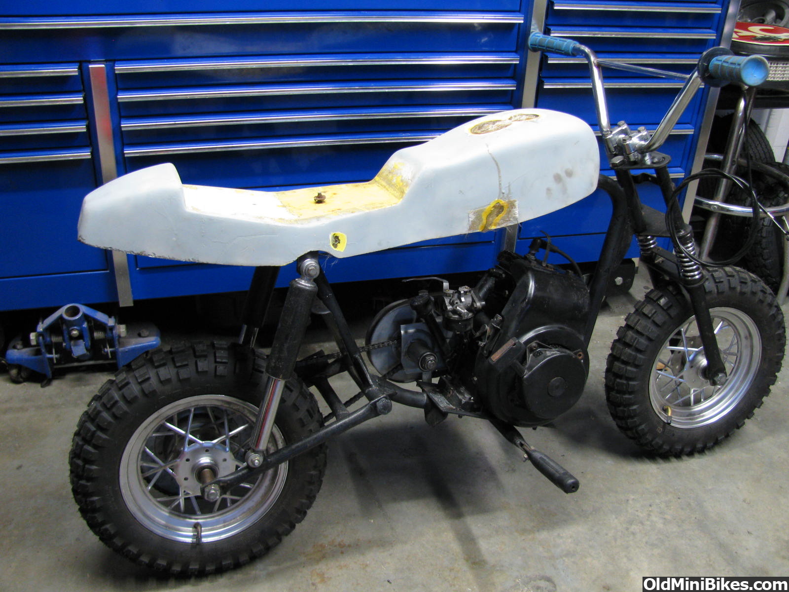

So while this bike ran killer, it was puffing smoke more than a ragged out 2 stroke with a double dose of oil dumped in the tank :laugh: I knew when I took the head off upon fist cleanup it might be an issue as the cylinder wall didn't look great. but I figured Id give it a shot.....and it was a fail :shrug:

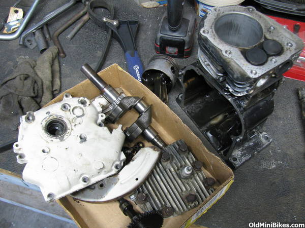

So last night I dug out form under my bench another HS40 that had come on a Bonanza I bought awhile back. it was probably off a snowblower, the crank was not drilled/tapped and it didn't have a throttle control. I had been robbing parts from it but I knew it was clean internally.

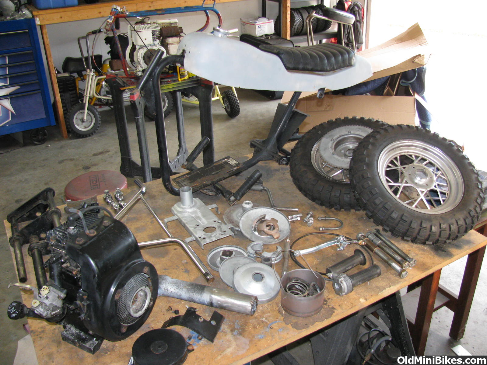

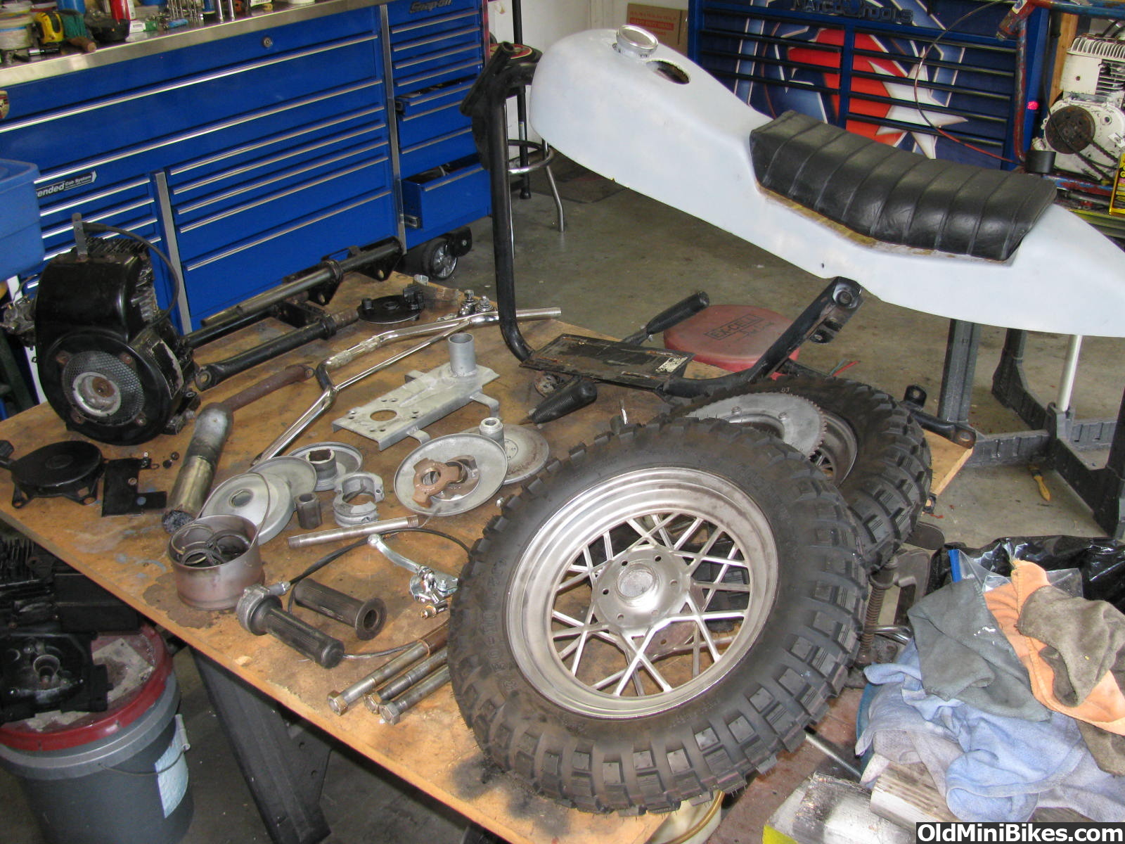

Bummer was I have to have a drilled and tapped crank for the TC so I yanked the engine off the bike and disassembled the 2 engines, crossed my fingers the the crank journals were not roached and swapped them out.
the old block and parts I didn't use off the white one:

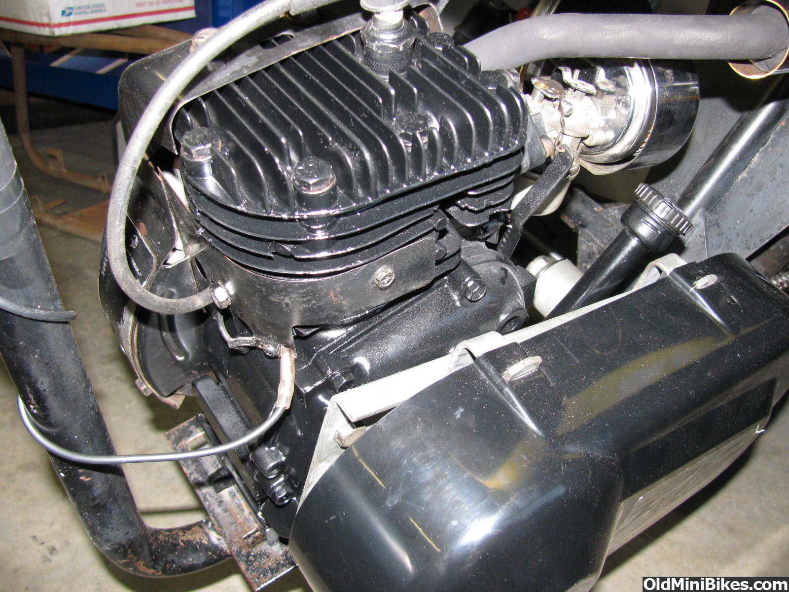

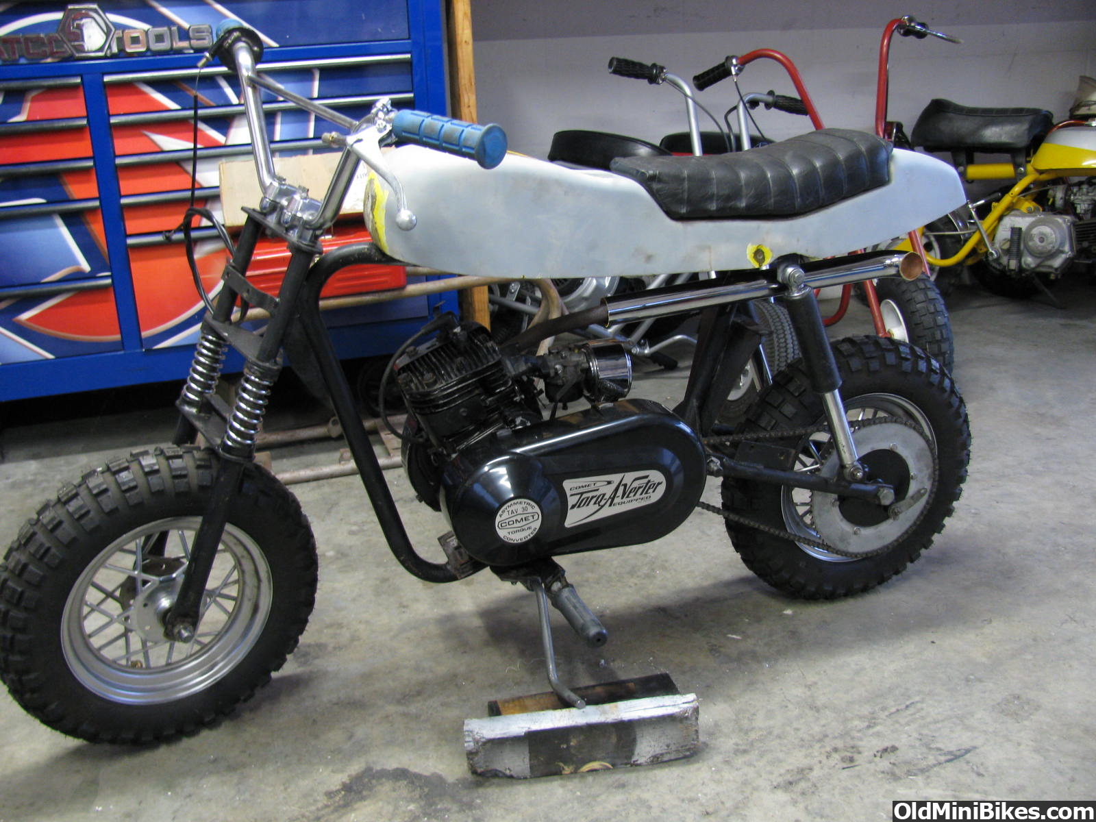

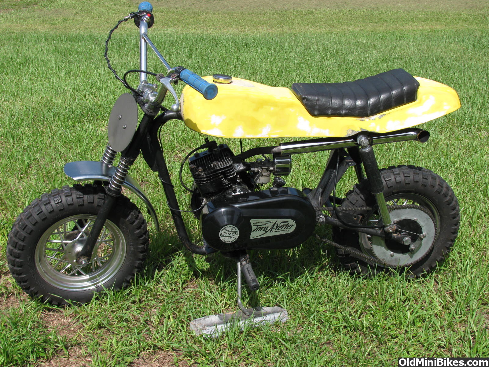

I threw it all together early this morning, took the mechanical compression release off the cam that was in the white engine so it will idle better, lapped the valves, polished the journals etc.. It Looked like a piano with white block black sidecover and head so I wire wheeled real quick, cleaned it off and sprayed it semi gloss black. couple hours later my buddy Dan the Lil Indian man stopped by to pick up some parts/bike I was working on for him and he cheered me on as I set the timing, threw it all back together and bolted it on the bike ( I think he was actually waiting for me to get mad and throw my usual temper tantrum when something goes wrong :cursing
But it fired right up and ran great!!!!! no more smoke :thumbsup:
So friggin hot down here the paint was dry and set quick so I didn't even bugger that up putting it back together :thumbsup:
