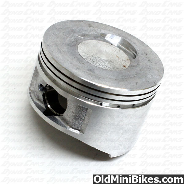

Any one see the new Ducar 212 replacement piston on the DynoCams web page? It looks like it is clearanced for the intake valve. If this is true and only $9 it might be a great budget upgrade for some people. It's a dished piston which is a little surprising. We might have a new part for out motors I was looking to see if they sell the cranks yet but its a no. They ever start selling just the short bock with out the flywheel though I would buy one in a hurry. Looks like the Ducar 212 is a low compression motor. With the dished piston it also has a .052" head gasket. I am hopping they have the piston flush with the deck of the block now so racers can control compression a little better. I also noticed they have the replacement rod labeled as a heavy duty rod so maybe it is hardened like the BSP rods. I kinda wish I had some coin for one of these motors
