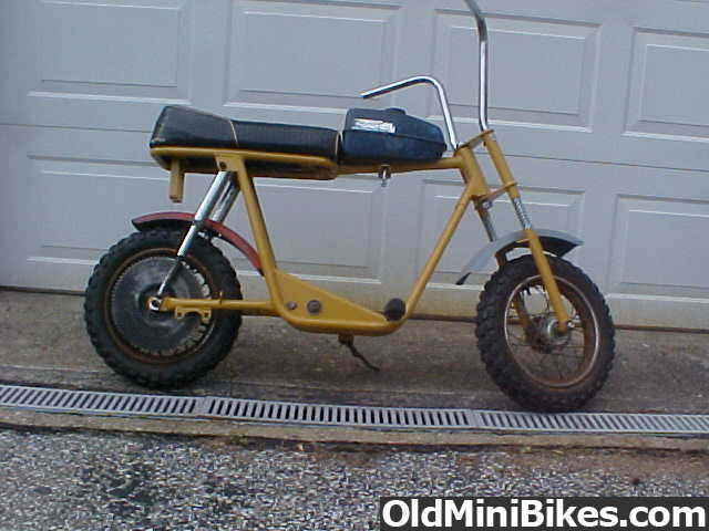

I picked this bike up last spring from Craigslist. Not 100% sure what direction I'm going to go with it but I want to get started on it. It's pretty complete but also well worn. It's missing everything related to the brakes, the headlight, the gas tank, the seat and has been converted from a 2 speed centrifugal to a single-speed. The engine appears to be the original HS40 with lighting coil with a 1969 serial number. Engine runs fine after a carb rebuild.
I picked up a cheap correct tank that is appropriately beat up for this bike.
Can anyone show me what this tank is supposed to have on the bottom? The mounts are one the frame but whatever is supposed to be on the tank is long gone and I can't find any pictures of the bottom of one of these tanks.
Plans for now are to get the tank fixed and mounted. I need to work on the throttle which is a bit messed up and not operating smoothly. Then I need to figure out brakes for it. I'm leaning towards putting some hydraulic calipers on both the front and back. From there I'll see if I can save any of the chrome and then start figuring a powdercoat scheme.
