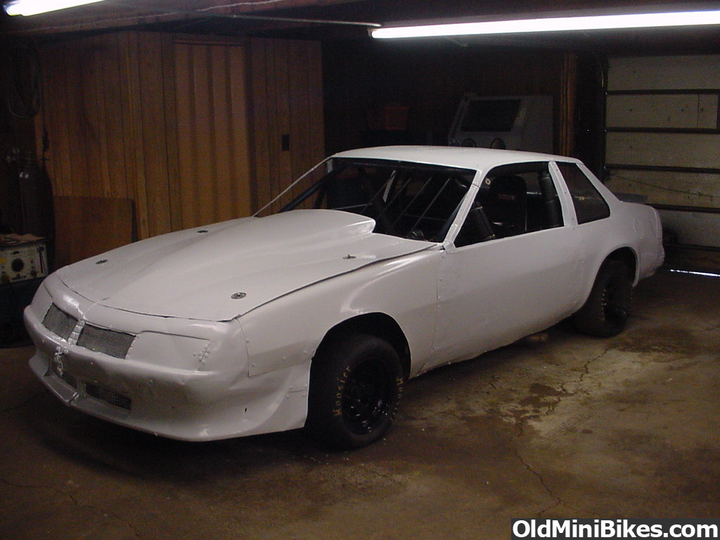

The car is a Monza Pro4. I bought the car complete and running but just had to take it apart and change some things. It has a very strong 2.5 engine. Ported head, roller rockers, roller cam, .625 lift cam (too much in my opinion) forged pistons, Crower rods, the stronger 2.5 crank, racing oil pan, 350 Holley carb, gear reduction starter. It also has a very nice roll cage. Good design and well executed.
I used the steel roof for a mold and made a fiberglass copy to reduce weight and came up with an insert system to adjust caster and camber. Original system was an offset control arm bushing that had to be removed and rotated to change settings. Not something you could do at the track. Also did routine maintenance such as replacing bushings and bearings, repairing the fiberglass hood, redoing some machine work on the hubs, and replacing the wheels and tires.
