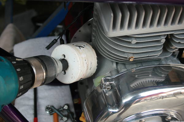

All this discussion about blow by has me motivated to reduce the crankcase pressure in my 22.88HP Briggs flathead with 300psi cranking pressure! What do you think? Will this give me more power?
Yeppers, I read somewhere that you can eliminate blowby by drilling a 3/4" hole. I didn't know exactly where to drill the hole until you posted that picture though :laugh:
LOL! Good laugh for the day.
But o.k. I believe you, sheesh.
