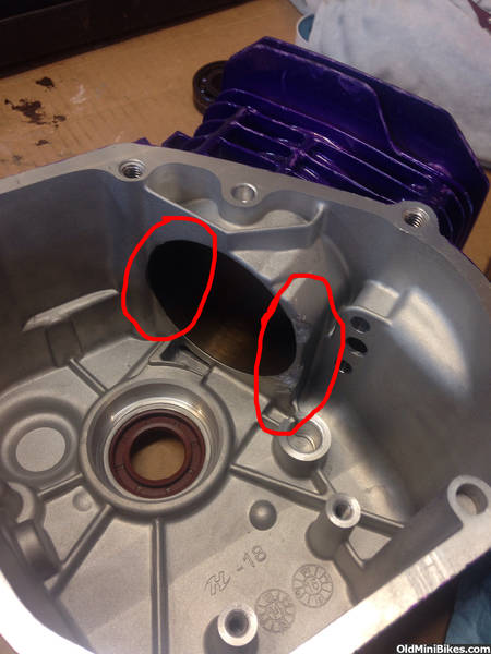

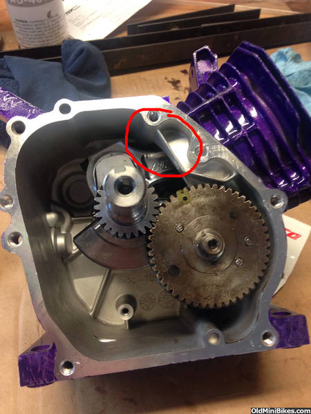

#10
You need to clearance the block for the rod with the stroker, atleast I had to any way. I should have some pics of it laying around, just have to find them first.
#12
I couldn't find one after I took after clearancing for the crank. But I found when I clearances for the cam. The area I circled up top in the first picture shows where I had to clearance for the crank. Just about as much as the cams I had to grind off. On the second picture you can see how close the top of the rod gets to the bottom of the cylinder.

#13
just curious what honda casting is that with no gov holes or low oil sensor hole ?? even if you did want to brace it now you would have to get rid of the powder coat in those areas :thumbsup:
#15
