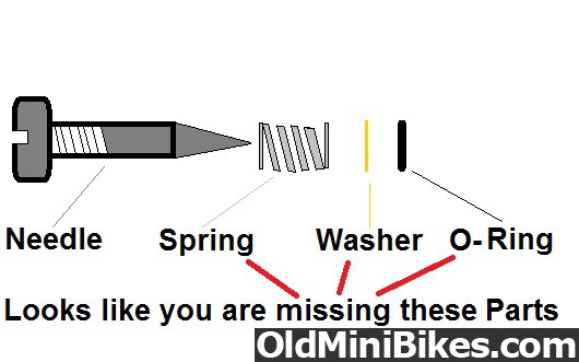

i just finished swapping a 10hp Tecumseh from a snow-blower into my go kart. i fully cleaned the carb and have the throttle hooked up to carb with out governor. it starts easy and runs great but i cant get it to idle low enough to fully release the torque converter. if i turn the stop screw down where it sounds right after a few seconds it bogs down and dies. to me it doesn't look like there's any adjustments on this carb other than the idle stop screw. there is one jet on the side right above the bowl but im pretty sure its not adjustable because it had a cover over it and if its not fully seated it seems loose.
