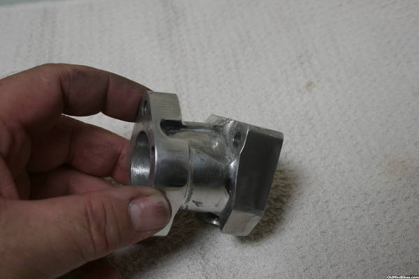

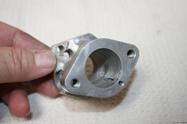

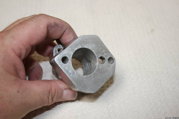

I have an aluminum intake that you can make work. Most of the mikuni's are 48MM between mounting holes...on this intake they are 46MM apart...a little grinding and you are home free...may also have to plug the vacuum port, but a set screw will take care of that...pm me if you want to give this a try...I will make you a deal!
