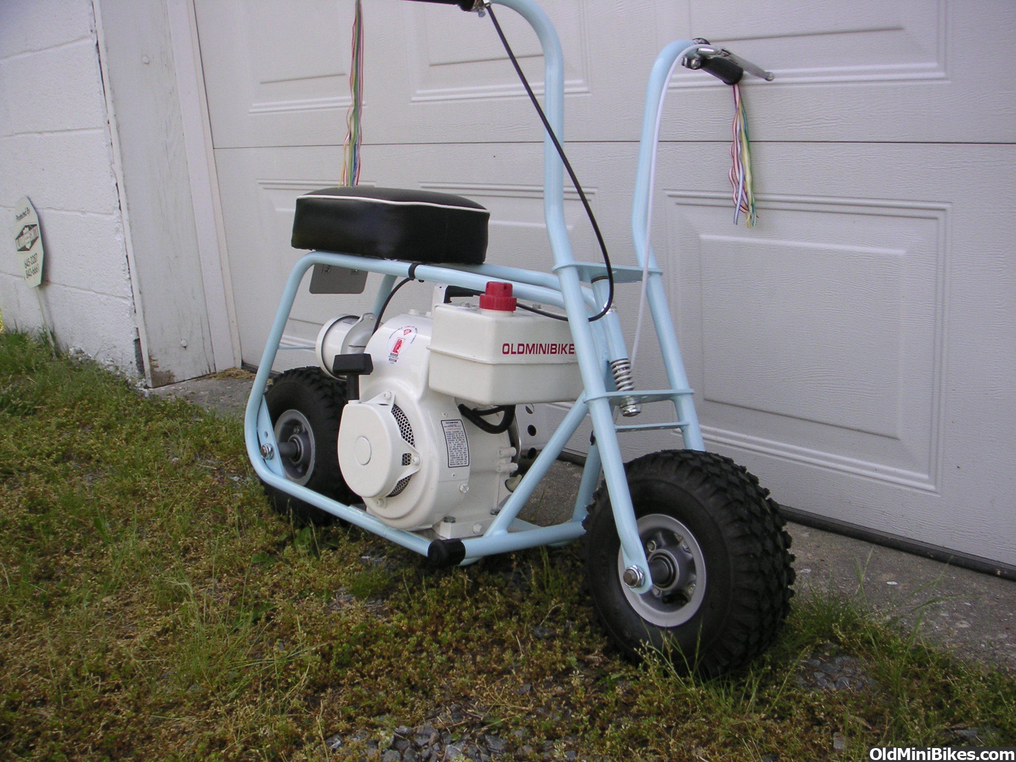

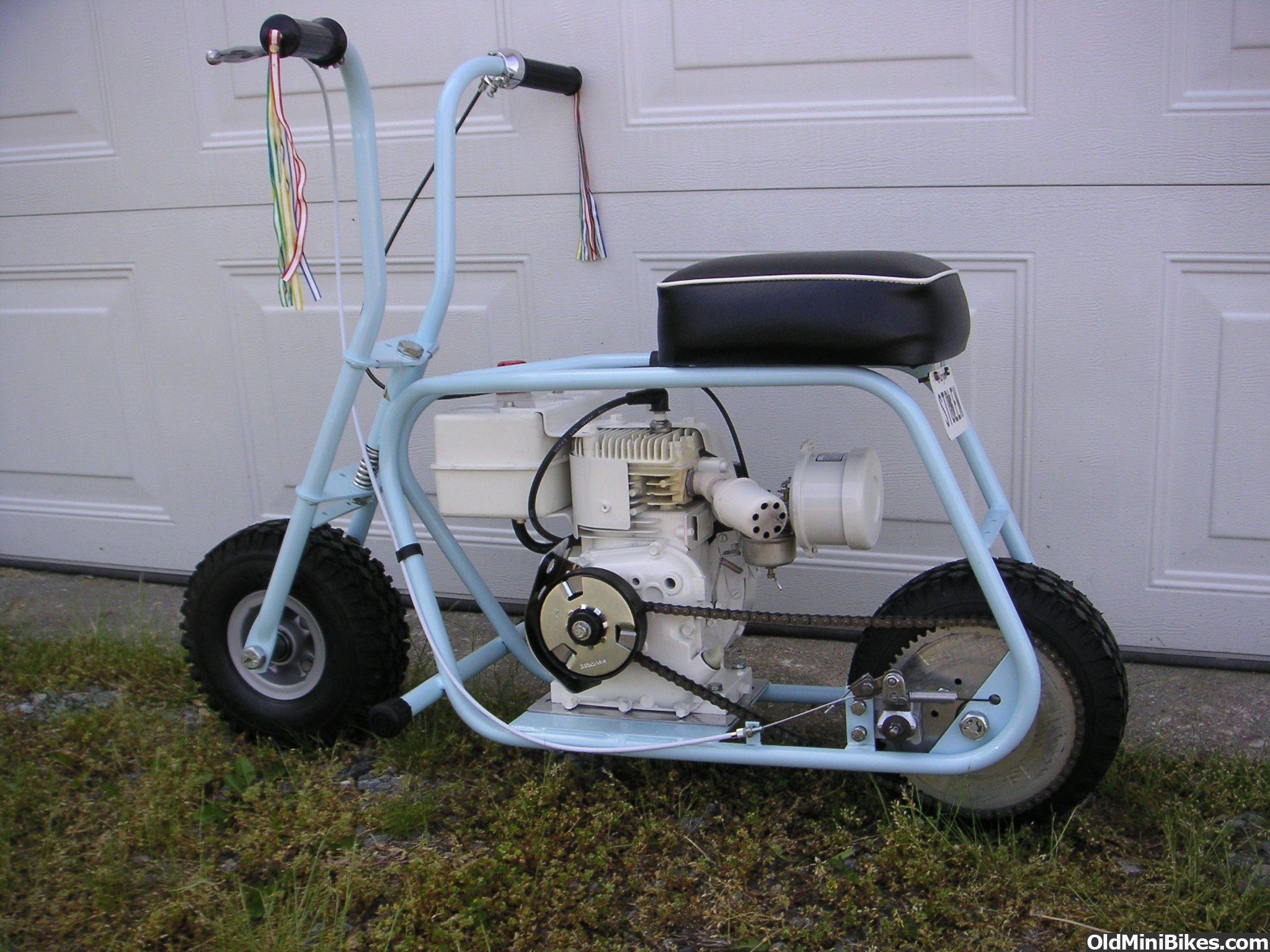

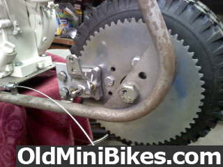

I finally finished it,I think
powder blue with a little gold pearl in the clear coat for the wild factor...
nice little vintage h30 completly rebuilt,head decked-cyliner honed .020 over
nos. piston rings and rod,stuffs getting a little hard to find... valves
refaced-seats ground.it has so much compression you have to put your
knee on the seat when you pull start it or the whole bike comes off the
ground.nice reproduction brake caliper,yep someone does make them.
origional 4" mags,runs like a top.I had alot of fun doing this one,Im almost
ashamed at what I spent on it but not really...some people spend 30 grand
a year just to golf...
