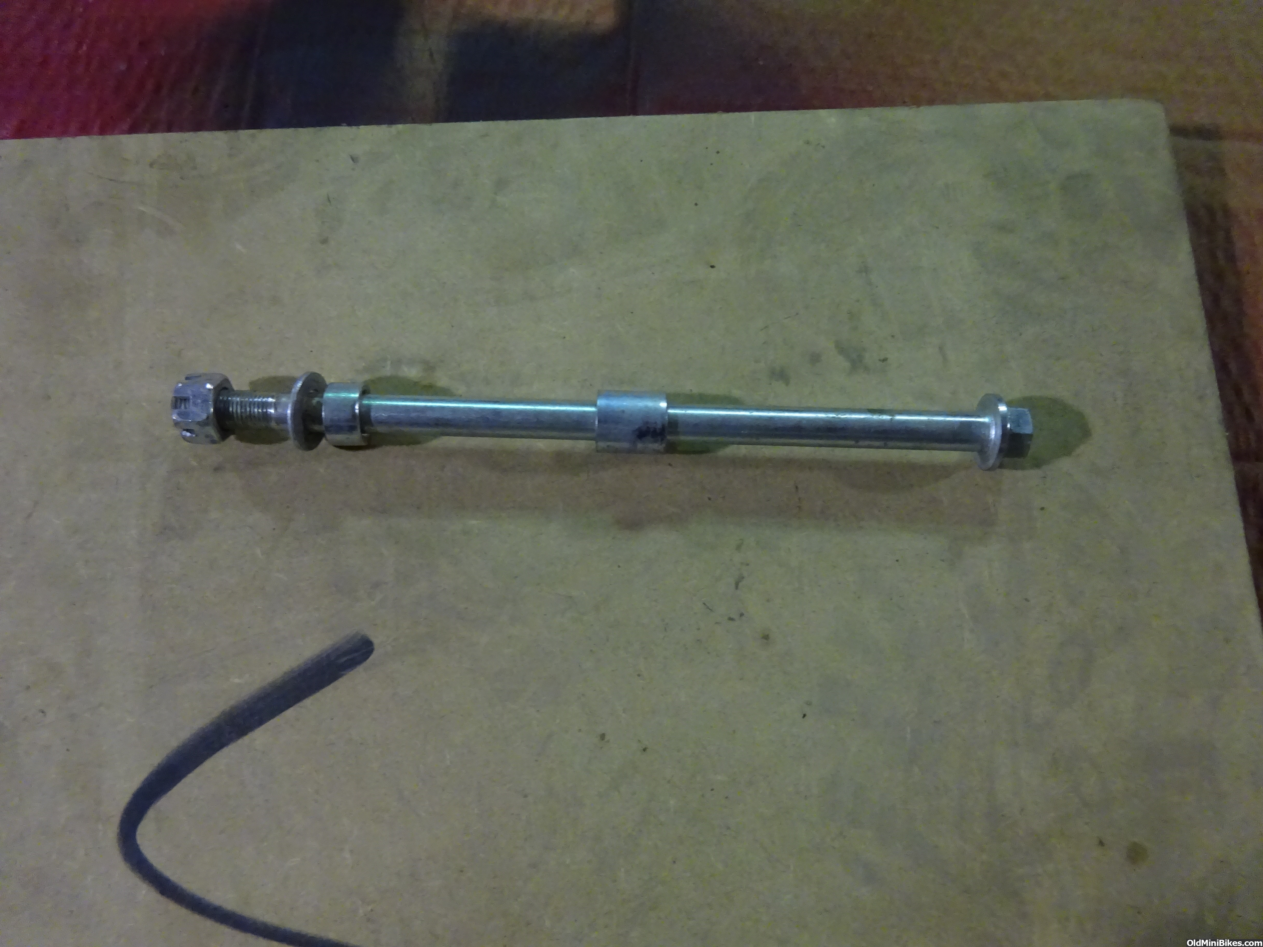

measure the length , a DB axle would most likely work and please cut your own spacers 3/4" O.D. tubing is about a perfect match !
#5
DB30 rear axle.
PM me your address and I will send you one. If it works you can pay me for it. If it wont work, just throw it on the shelf.
Doug
