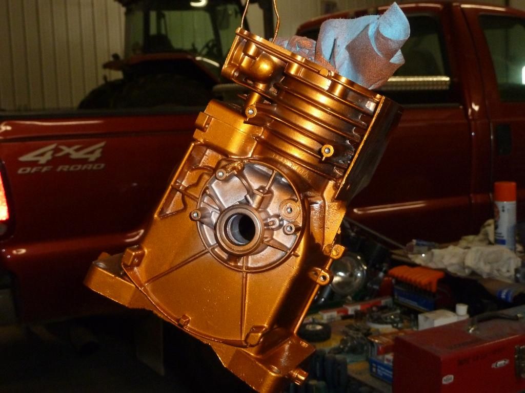

I had this old B&S 2.5hp kicking around and I figured I should do something with it. I don't have a bike lined up for it as of now, but at least it will be ready to go when I need it.
I started off stripping the motor down to the bare block. I then soaked the block in gas and scrubbed it with a tooth brush until all the grease and other sh@t was off. I let it dry and then I scrubbed it with acetone and then used a scotch bright pad to remove the loose paint. I let the block dry and then it was time for paint. I used VHT engine block metallic paint, it was a close match to the copper that was on it originally. Right now the block is drying.

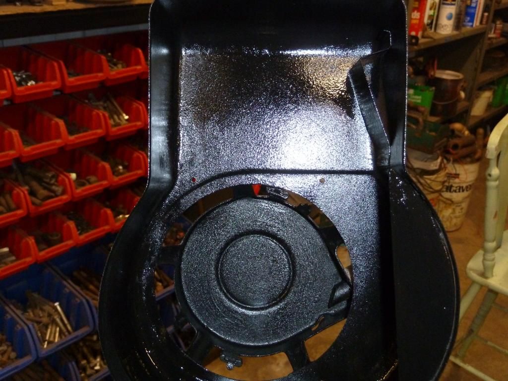

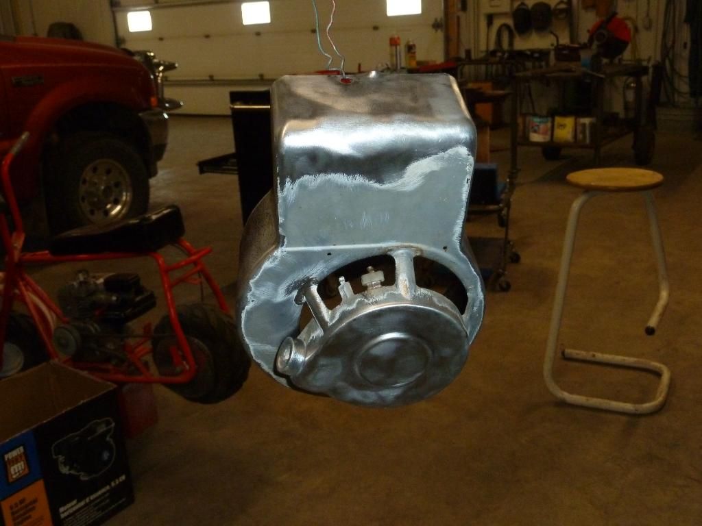

The rest of the parts are soaking in gas to loosen up the grease so I can wipe it right off. So in the mean time I stripped the shroud down to bare metal with a wire wheel. After that I painted the inside of the shroud with black VHT wrinkle finish spray bomb to cover up the pitting. Right now that is drying, so I will have to wait before I paint the outside the same color as the block.
