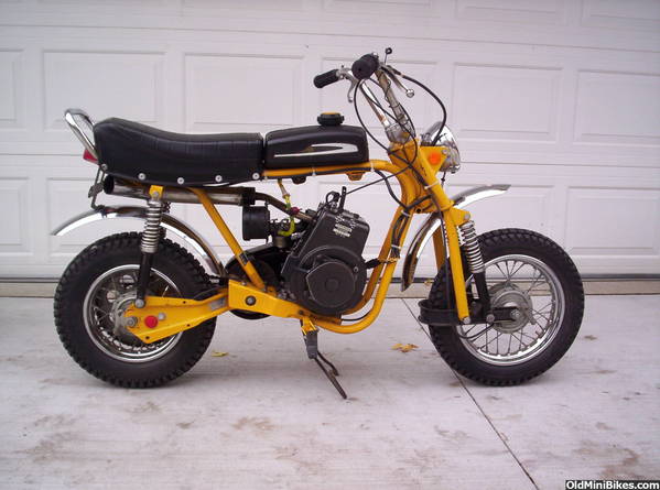

Here is a nice one out of the picture archives. Pretty complicated bike, What are you trying to do, make a rider or do a resto? I don't know how well it would run without the angled intake, probably can find one here or make one. You would need to find a motor with a lighted coil to run the lights.
Never thought about how it would run without a slanted intake. Probably going to send it to craigslist to fund the other bike projects.
buckeye
That could be a cool bike. Either resto or just throw it together and make it a fun beater. Has suspension,that's a great start.
