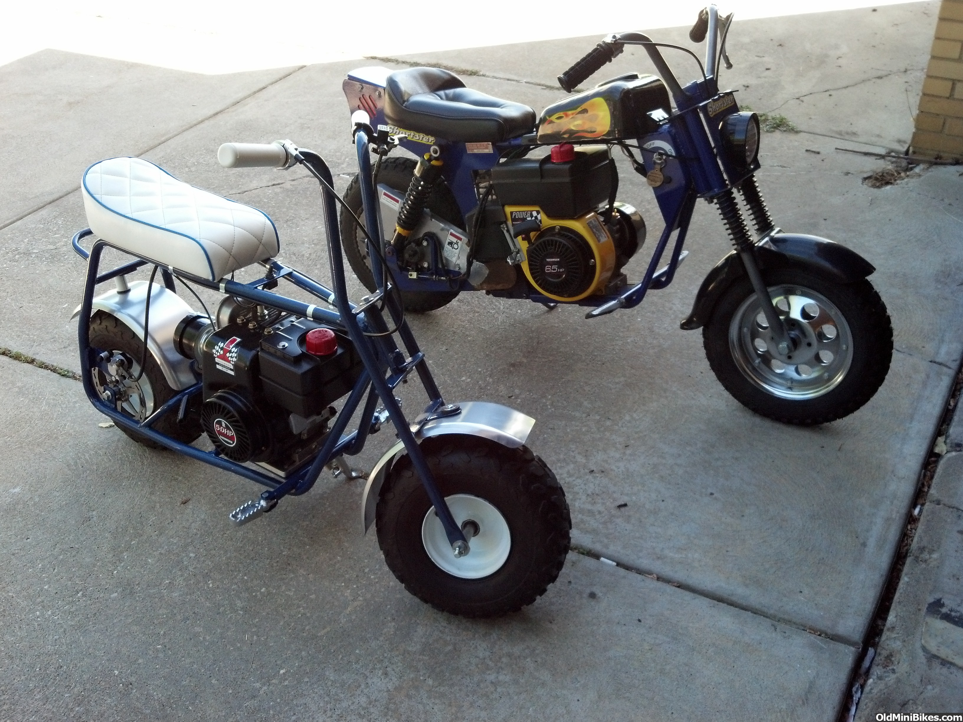

I also own a Shortster

Dang Doc, that you only had Foxes. That seat on the db is nice.
