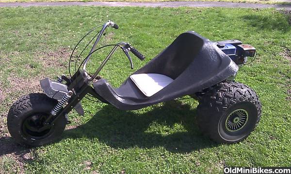

My first one had some chips and breaks. A little separation of gel coat and fiberglass undercoat, all the typical issues. A little fiberglass work, some extra mat, on the underside, to increase overall strength and it turned out pretty good.
