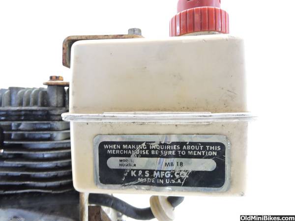

The bikes may have something like this somewhere as well, I spotted this K&S ID decal on something that was for sale recently and saved to my files for reference. but may be stick on the bikes somewhere
K&S decal:
