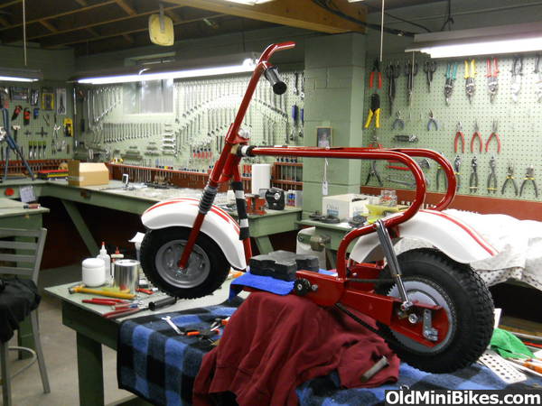

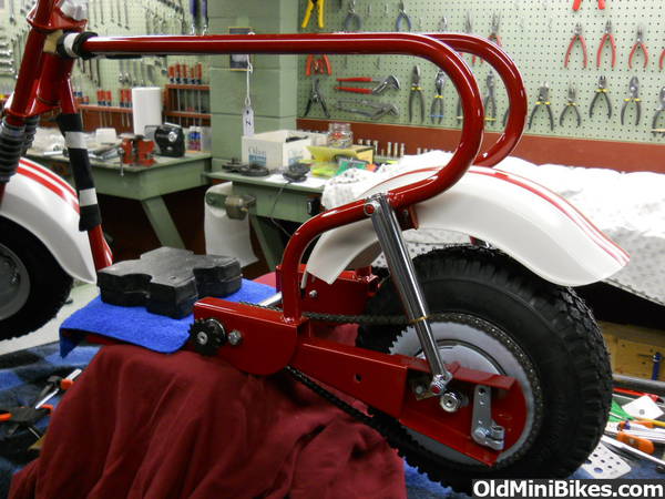

If I remember correctly, this is one of three 1962's.
These will be the finest restored Campuses in the country.
Wow! If I knew that these pics were going to be posted on the board I would have dressed up and shaved...lol. I'm doing one 1962 with the straight handlebars in the original Hi Fi red color. Sometime in late 62 or early 63 they bent the handlebars and kept the Hi Fi red. I'm also doing one of those. Between late 63 and 65 they changed to various shades of Hi Fi blue. I'm doing five of those. And from 65 to 69 they went with various shades of Seafoam blue. I'm doing three of those. I also have a 1961 with square metal fenders sitting on the shelf which I will work on after I finish these ten. All the components for all ten bikes (with the exception of the plastic cowling and exhaust pipes) are finished and painted and are just waiting for assembly. I took the pattern for the cowling / seat pan to my fiberglass man last week to have a casting made which I will then turn into a vacuform mold. In the meantime I decided to begin assembly of the ten Campuses. I'll keep you posted as things progress.
